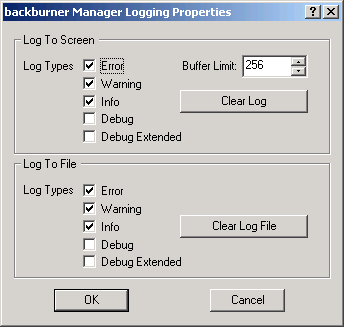

Logging Properties Dialog
The Logging Properties dialog lets you specify the types of messages that appear in the list window on the Manager or Server window and those that are sent to a log file. Each type of log message is explained below.

Interface
Log To Screen group
The Log To Screen options determine which types of messages are displayed in the list window of the Manager or Server window.
Turn on each type of message that you want to be displayed. Error, Warning, and Info are on by default.
Log To File group
The Log To File options determine which messages saved to log files. These are the same messages that appear on the screen. Turn on any of the following categories to save it in a log file. When any one of these categories is turned on, a manager.log file or server.log file is created in your \network directory. Error, Warning, and Info are on by default.
Buffer Limit
Specifies the maximum size of the buffer holding the messages.
Clear Log
Clears the buffer holding the messages in the list window.
Clear Log File
Deletes the associated manager.log and/or server.log file.
Warning: Log files are cleared only when you click the Clear Log File button. When categories are enabled for either or both log files, the files will continue to grow in size each time you render.
