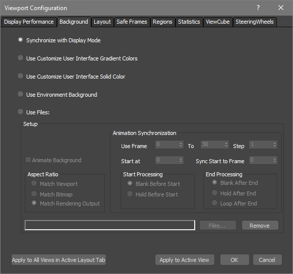

Provides options for viewport background display.
Interface
- Synchronize with Display Mode Displays the background as a gradient if the environment is black, otherwise the Environment background is used. Exceptions are the Consistent Color, Hidden Line, Wireframe, Bounding Box, and ModelAssist display modes that have a solid grey background. Default=on.
- Use Customize User Interface Gradient Colors (The default for
Perspective viewports.) Displays the background as a gradient.
To customize the gradient colors, use the Customize User Interface dialog
Colors panel
Viewport Background Gradient Bottom and Viewport Background Gradient Top options.
- Use Customize User Interface Solid Color (The default for
axonometric viewports.) Displays the background as a solid color.
To customize the solid background color, use the Customize User Interface dialog
Colors panel
Viewport Background option.
- Use Environment Background Displays the background specified on the Environment panel.
- Use Files Displays an image used for viewports only.
You can display an image in one or all viewports. You might use images for modeling, for example, by placing front, top or side view sketches in the corresponding viewports. Or use a viewport background image to match 3D elements with digitized camera footage, or for rotoscoping.
You select the image or animation to display in the active viewport, set the frame synchronization between the animated image file and the current scene, and turn the assigned image on and off. These changes do not affect the rendered scene.
To place an image in the background of the rendered scene, use the Environment And Effects dialog
Environment panel, accessed from the Rendering menu.
Note: When a viewport shows safe frames and the Aspect Ratio option is set to either Match Viewport or Match Rendering Output, the assigned viewport background image is confined to the Live area of the safe frames and correctly matches the rendered background bitmap.Setup group
- Animate Background
- Turn on to use an animated background. See To display an animated background. Default=off.
Aspect Ratio group
Controls the proportions of the viewport background by matching it to the bitmap, rendering output, or to the viewport itself.
Match Viewport
Changes the aspect ratio of the image to match the aspect ratio of the viewport.
Match Bitmap
Locks the aspect ratio of the image to the native aspect ratio of the bitmap.
(The default.) Changes the aspect ratio of the image to match the aspect ratio of the currently chosen rendering output device.
Note: When the Match Bitmap or Match Rendering Output option is chosen, 3ds Max centers the image and if necessary, clears the edges of the viewport to the default background color.Animation Synchronization group
Controls how sequences of images (for example, from IFL, AVI, or MOV files) are synchronized to the viewport for rotoscoping.
- Use Frame
The first field sets the first frame of the incoming sequence that you want to use, and the second field sets the last one.
- Step
Sets the interval between the frames you want to use. For example, if this spinner is set to 7, 3ds Max uses every seventh frame.
- Start At
Specifies the frame number at which you want the first input frame to appear. What happens in the viewport before the start frame depends on the option you choose for "Start Processing," below.
- Sync Start To Frame
Determines which frame from your incoming sequence is displayed at the Start At frame. For example, you could have a 30-frame IFL sequence that starts in your scene at frame 10, but you could use the 5th frame from the IFL on frame 10 by setting Sync Start to 5.
- Start Processing
- Determines what happens in the viewport background before the start frame.
- Blank Before Start Makes the viewport background blank before the start frame.
- Hold Before Start Specifies that the viewport background will contain the start frame.
- End Processing
- Determines what happens in the viewport background after the last input frame.
- Blank After End Makes the viewport background blank after the last input frame.
- Hold After End Specifies that the viewport background will contain the last input frame until the last frame in the animation.
- Loop After End Specifies that the viewport background will loop from the end frame back to the start frame, ad infinitum.
- [file name field]
- Displays the path and file name of the bitmap you have chosen.
- Files
Click to open a Select Background Image dialog, which lets you select a file or sequence of files for your background.
- Remove
- Click to remove the currently chosen background image.

To assign an image to one or all viewports:
- Activate the viewport that is to display the background image.
- Open the Viewport Configuration dialog to the Background panel (keyboard shortcut: Alt+B).
- Choose Use Files.
- In the Setup group, click the Files button.
This opens the Select Background Image dialog.
- Use the dialog to open the image or animation to use.
- To display the image in a single viewport, click Apply to Active View. To display the image in all viewports, click Apply to All Views in Active Layout Tab.
- Click OK.
The image is displayed in a single viewport or all viewports.

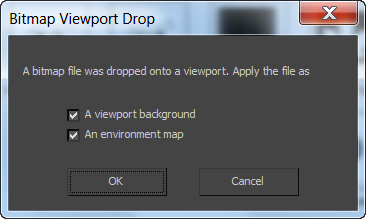

To assign a viewport background by dragging and dropping:
- Browse images in Windows Explorer or in another graphics-browsing application.
- Select a thumbnail of the bitmap with your mouse and drag it onto an empty area of a viewport.
Do not drop the map onto an object: This creates a material instead of assigning a background.
3ds Max opens the Bitmap Viewport Drop dialog:
- A viewport background
- When on, puts the bitmap into the viewport as a background.
- An environment map
- When on, includes the bitmap when you render the viewport.
- Click OK.
