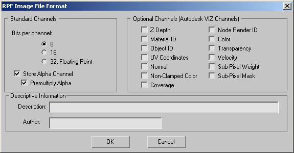

Interface
When RPF is the chosen output format, clicking Render or Setup on the Render Output File dialog displays the RPF Image File Format dialog.
Standard Channels group
The standard channels are RGB color and the alpha (transparency) channel.
Bits per Channel
Choose 8, 16, or 32 Floating Point as the number of bits per channel. Default=8.
Store Alpha Channel
Choose whether to save the alpha channel. Default=on.
Premultiply Alpha When on, premultiplies the alpha channel. Default=on.
Premultiplying saves computation time if you later use this image in compositing. See Premultiplied Alpha for more information.
Optional Channels group
For output RPF files, there are additional channels that you can generate (and view in the Rendered Frame Window).
Note: The Quicksilver hardware renderer can generate only these optional channels: Z Depth, Material ID, and Object ID.
Z Depth
Saves Z-Buffer information in repeating gradients from white to black. The gradients indicate relative depth of the object in the scene.
Material ID
Displays the Effects channel used by materials assigned to objects in the scene. The Effects channel is a material property set in the Material Editor and used during Video Post compositing. Each Effects Channel ID is displayed using a different random color.
Object ID
Displays the G-Buffer Object Channel ID assigned to objects using the Object Properties dialog. The G-Buffer ID is used during Video Post compositing. Each G-Buffer ID is displayed using a different random color.
UV Coordinates
Saves the range of UV mapping coordinates as a color gradient. This channel shows where mapping seams might occur.
Note: UV Coordinates will not be displayed on objects that have the UVW Map Modifier applied unless a map has been applied that uses the coordinates.
Normal
Saves the orientation of normal vectors as a grayscale gradient. Light gray surfaces have normals pointing toward the view. Dark gray surfaces have normals pointing away from the view.
Non-Clamped Color
Saves areas in the image where colors exceeded the valid color range and were corrected. The areas appear as bright saturated colors usually around specular highlights.
Coverage
Saves the coverage of the surface fragment from which other G-buffer values (Z Depth, Normal, and so on) are obtained. Z-Coverage values range from 0 to 255. To see Z Coverage, render to an RLA file after first checking Z Coverage in the Setup subdialog, then choose Z-Coverage in the Rendered Frame Window's Viewing Channel drop-down list.
The Z-Coverage feature is provided primarily for developers, and should aid in the antialiasing of Z-buffers.
Node Render ID
Saves each object as a solid color according to its G-Buffer Object channel (found under Object Properties).
Color
Saves the color returned by the material shader for the fragment. This channel displays any transparent fragment as a solid color.
Transparency
Saves transparency returned by the material shader for the fragment. Any fragment with any degree of transparency will be rendered as a solid gray object.
Velocity
Saves the velocity vector of the fragment relative to the screen in screen coordinates.
Sub-Pixel weight
Saves the sub-pixel weight of a fragment. The channel contains the fractions of the total pixel color contributed by the fragment. The sum of all the fragments gives the final pixel color. The weight for a given fragment takes into account the coverage of the fragment and the transparency of any fragments that are in front of a given fragment.
Sub-Pixel Mask
Saves the sub-pixel alpha mask. This channel provides a mask of 16 bits (4x4) per pixel, used in antialiased alpha compositing. This mask is especially useful with the Combustion compositing product.
Descriptive Information group
This information is saved with the file.
Description
You can enter descriptive text here.
Author
You can enter your name here.
