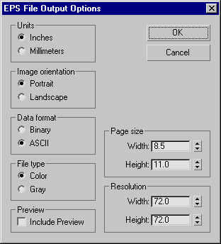

Interface
When PostScript is the chosen output format, clicking Render or Setup on the Render Output File dialog displays the EPS File Output Options dialog.
Units
Select inches or millimeters.
Image Orientation
Select portrait (tall) or landscape (wide).
Data Format
Select binary or ASCII.
File Type
Select color or grayscale.
Preview
Check to generate a thumbnail image so that file browsers can preview the contents of the PostScript file.
Page Size
Set width and height measurements.
Resolution
Set width and height resolution in dots per inch (dpi).
