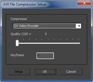

When AVI is the chosen output format, clicking Render or Setup on the Render Output File dialog displays the Video Compression dialog.
Compressor
Use the drop-down list to choose the codec (compressor/decompressor) you want to use to compress the file. You can use any codec that's installed on your system.
Alternatively, you can render uncompressed frames and then use an external application to compress the animation. Video-file compression is a complex subject, with many aspects to consider.
Note: When using the 64-bit version of 3ds Max, the default compressor is DV Video Encoder. The only output resolution this encoder supports is 720 x 480. To use another output resolution, set Compressor to a different option.
Compression Quality
Available only for certain codecs. When available, use the slider to specify the quality you want. The higher you set the quality, the larger the file size will be.
Keyframe Rate
Available only for certain codecs. When available, use this setting to specify the interval between the delta keyframes used to compare one frame with another and generate in-between frames. Too large an interval will create loss of quality in the AVI file as a whole.
Setup
Available only for certain codecs. Click this button to see any additional options that are specific to the codec. These are vendor specific and vary from codec to codec.
