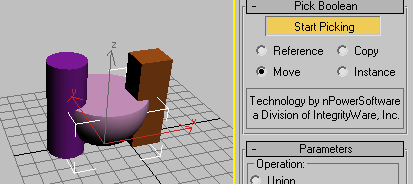

  3. On the Create panel, with (Geometry) active, choose Compound Objects from the drop-down list. On the Object Type rollout, turn on ProBoolean.
  4. On the Parameters rollout, in the Operation group, choose Intersection.
  5. On the Pick Boolean rollout, click Start Picking, and then click the sphere.
    The result is the intersection of the sphere and the box; that is, a single object that represents the common volume both objects occupy. In this case, it's the overlap of the sphere and the box. Although neither has a material at this point, the result uses the default color originally assigned by 3ds Max, at random, to the box when it was created.
    Note that Start Picking stays active (blue or yellow, depending on the color scheme). This means you can continue picking objects to incorporate into the Boolean object, optionally changing the operation as you go.

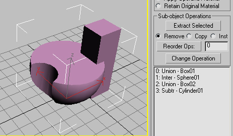

  7. Set Operation to Subtraction, and then click the cylinder.
    The cylinder's intersecting volume is subtracted from the previous Boolean result.
    Note that the entire history of operands and operations used to build the Boolean object is listed in the hierarchy view list at the bottom of the Parameters rollout. Box01 starts the Boolean with Union, Sphere01 is then incorporated with Intersection, Box02 is incorporated with Union, and finally Cylinder01 is incorporated with Subtraction.
    Note: The operation for the first object in the list has no effect on the Boolean object, but if you move it to another position in the list it does. You'll see an example of this at the end of this exercise.
    You can use the list and the other controls in the Sub-object Operations group to change the results.

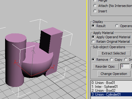

  8. In the list, highlight the Subtr - Cylinder01 entry, and then set Operation to Union.
  9. In the Sub-object Operations group, click the Change Operation button.
    As a result of the change of operation, the cylinder appears in the Boolean object as an additive volume instead of a subtractive one. Also, its entry in the list changes to “Union - Cylinder01”, showing that the Boolean operation for the cylinder is now Union.
    You can also change the order of the operations, which can affect the results.
  10. In the list, click the Union - Cylinder01 entry to remove the highlighting, and then highlight the entry 1: Inter - Sphere01.
    Note that its position in the list, 1, appears in the editable field next to the Reorder Ops button.
  11. Change the value in the field from 1 to 3, and then click the Reorder Ops button.
    The Inter - Sphere01 item jumps to the end of the list.
    The Boolean object changes significantly. The new order in the list tells you how this shape was achieved: The two boxes and the cylinder were all combined with Union, adding their volumes together, and then the sphere was incorporated into that result with Intersection, leaving only the volume shared by all four objects.

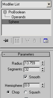

With an unmodified ProBoolean object selected, the modifier stack shows a single, expandable entry: ProBoolean.
Expanding this entry (by clicking the + icon) reveals a single subsidiary branch: Operands.
To transform operands in the ProBoolean object independent of the entire object, click the Operands branch to highlight it.
You can then select one or more operands, either by using standard selection methods in the viewport, or by highlighting their names in the hierarchy view list at the bottom of the Parameters rollout.
When one, and only one, operand is selected, the object type (not its name) appears as a separate stack entry below the ProBoolean entry. Clicking this entry provides direct access to the operand's parameters on the Modify panel.
If Parameters rollout Display is set to Result, selecting an operand displays the operand's axis tripod or transform gizmo in the viewport, although the operand itself is not visible by default.
To view the operand, set Parameters rollout Display to Operands.

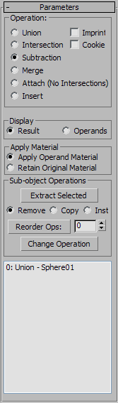

Operation group
These settings determine how the Boolean operands interact physically.
Union
Combines two or more separate entities into a single Boolean object.
Intersection
Creates a "new" object from the physical intersection between the original objects; the non-intersecting volumes are removed.
Subtraction
Removes the volume of a selected object from the original object.
These functions operate on operands highlighted in the hierarchy view list (see following).
Note: For these operations, you need not be at the Operands sub-object level in the modifier stack.
Extract Selected
Based on the chosen radio button (Remove, Copy, or Inst; see following), Extract Selected applies the operation to the highlighted operand in the hierarchy view list. Three modes of extraction are available:
  • Remove Removes the operand or operands highlighted in the hierarchy view list from the Boolean result. It essentially undoes the addition of the highlighted operand(s) to the Boolean object. Each extracted operand becomes a top-level object again.
  • Copy Extracts a copy of the operand or operands highlighted in the hierarchy view list. The original operand remains part of the Boolean result.
  • Inst Extracts an instance of the operand or operands highlighted in the hierarchy view list. Subsequent modifications to this extracted operand also modify the original operand, thus affecting the Boolean object.
Reorder Ops
Changes the ordering of the highlighted operand in the hierarchy view list. The reordered operand is moved to the position listed in the text field next to the Reorder Ops button.
Change Operation
Changes the type of operation (see Operation group) for the highlighted operand. To change the operation type, highlight the operand in the hierarchy view, then choose the operation type radio option, and then click Change Operation.
[hierarchy view]
The hierarchy view, found at the bottom of the Parameters rollout, displays a list of all of the Boolean operations that define the selected mesh. Each time you perform a new Boolean operation, 3ds Max adds an entry to the list.
