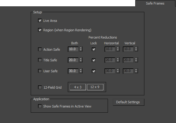

The Safe Frames panel contains settings for the following frame types:
Live Area
The area that will actually be rendered, regardless of the size or aspect ratio of the viewport. Default outline color = mustard.
Region (when Region Rendering)
When on and you're rendering a region, and Edit Region is off, the region outline remains visible in the viewport. When off, the region remains in effect but its outline does not appear in the viewport. When Edit Region is on, the region outline is always visible and this switch has no effect.
Note: To see the region outline in the viewport, Show Safe Frames In Active View must be on.
Action Safe
The area in which it's safe to include your rendered action. The Lock checkbox lets you lock the aspect ratio of the Action frame. When Lock is on, use the Both spinner to set the percentage of the live area that's trimmed within the safe frame. When Lock is off, you can use the Horizontal and Vertical spinners to set these parameters independently. Default = 10% of Live Area. Default outline color=cyan.
Title Safe
The area where it's safe to include titles or other information. When used correctly, this is smaller than the Action frame. The Lock checkbox lets you lock the aspect ratio of the Title frame. When Lock is on, use the Both spinner to set the percentage size of the title frame relative to the action area. When Lock is off, you can use the Horizontal and Vertical spinners to set these parameters independently. Default = 20% of Live Area. Default outline color = light brown.
User Safe
Displays an additional safe frame that you can use for any custom requirements. The Lock checkbox lets you lock the aspect ratio of the User frame. When Lock is on, use the Both spinner to set the percentage size of the user frame relative to the action area. When Lock off, you can use the Horizontal and Vertical spinners to set these parameters independently. Default = 20% of Live Area. Default color = magenta.
12-Field Grid
Displays a grid of cells (or fields) in the viewport. In this case, "fields" are cells in the grid, and not scanline fields.
The "12-field grid" is a method used by video directors to refer to specific areas of the screen. A director might ask you to move an object two fields to the left and four fields down. The 12-field grid is a reference for this type of placement.
  • 4 x 3 (The default.) Uses a 12-field grid of 12 cells.
  • 12 x 9 Uses a 12-field grid of 108 cells.
Application group
Show Safe Frames in Active View
Toggles the safe frames display for the active viewport. This option is duplicated by the Show Safe Frames toggle on the POV viewport label menu.
Default Settings
Resets all values to the default values.
