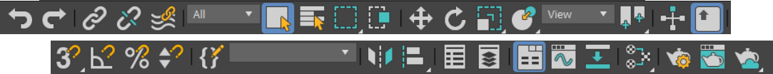

The main toolbar provides quick access to tools and dialogs for many of the most common tasks in 3ds Max.
The main toolbar, split in two for this illustration

Undo/Redo
Select and Link
Unlink Selection
Bind to Space Warp
Selection Filter List
Select Object
Select by Name
Selection Region flyout
Window/Crossing Selection Toggle
Select and Move
Select and Rotate
Select and Scale flyout
Note: Right-clicking the Move, Rotate, or Scale button opens the Transform Type-In dialog.
Select and Place flyout
Note: Right-clicking the Select And Place or Select And Rotate button opens the Placement Settings dialog, also described in Select and Place.
Reference Coordinate System
Use Center flyout
Select and Manipulate
Keyboard Shortcut Override Toggle
2D Snap, 2.5D Snap, 3D Snap flyout
Angle Snap Toggle
Percent Snap Toggle
Spinner Snap Toggle
Edit Named Selection Sets
Mirror
Align flyout
Toggle Scene Explorer
Toggle Layer Explorer
Toggle Ribbon
Curve Editor (Open)
Schematic View (Open)
Material Editor flyout
Render Setup
Rendered Frame Window
Render flyout
