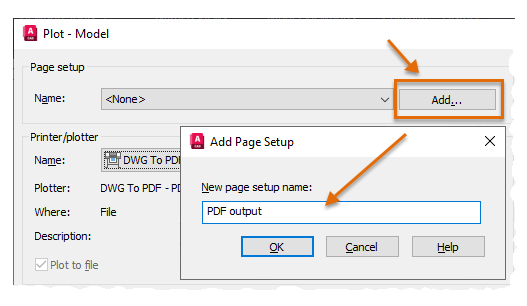

Save a Page Setup
  1. Open a drawing file of your choice.

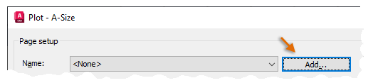

  2. On either the Model tab or a layout tab, click Plot. Find
  3. In the Plot dialog box, choose the settings that you want to save. For example, for the name of the Printer/plotter, scroll through the drop-down list and click DWG To PDF.pc3.
  4. Make any other changes and then click the Add button. Enter a name for the page setup such as PDF output, and click OK.
  5. At this point, you have several choices:
    • Click Apply to Layout to associate this page setup as the default for the current tab.
    • Click OK to create the PDF file.
    • Click Cancel to dismiss the dialog box. The page setup is still saved.
  6. Save the drawing.

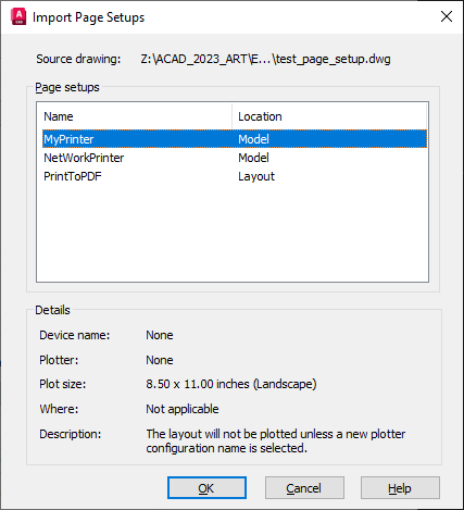

Import a Page Setup
Sometimes you'll open a drawing that doesn't include your page setups. This can occur with a drawing that you receive from someone else, or maybe an older drawing. Here's what you can do.

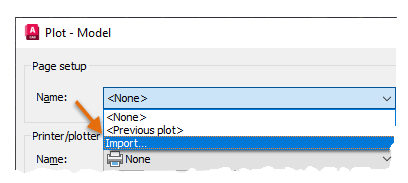

  1. On either the Model tab or a layout tab, click Plot. Find
  2. Choose the Import option in the Name drop-down.
  3. Choose a drawing that already uses your page setups.
    Note: If the page setups don't appear in the list:
    • Make sure the drawing containing the page setups has been saved.
    • Make sure the page setups were named and not just applied to a layout or model space.
    • Make sure you are in the same space; model or a layout, as the space for the page setup you want to import.
  4. Click the page setup that you want to import and click OK. To select multiple page setups, do one of the following:
    • If you want to import all of them, press Shift and choose the first and last one in the list.
    • If you want to import several of them, press Ctrl and choose the ones you want.
  5. Click OK or Cancel.
  6. Save your drawing.
Note: You can reduce the number of times that you need to import page setups by adding the named page setups to your drawing template files. Then, all new drawings based on those templates will automatically have them available.

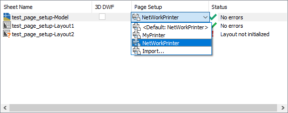

Using Page Setups in Batch Plotting (Publish Command)
Page setups are saved per drawing, and are specific to model or layout tabs. When you are batch plotting or publishing, the current page setup is used for each sheet selected. You can change the page setup for a sheet in the Publish dialog box.
  1. Click Output tab > Plot panel > Batch Plot. Find
  2. Add the sheets to publish.
  3. To change the page setup for a sheet:
    1. Click the current page setup name. This displays the drop-down arrow.
    2. Select a page setup from the sheet's drop-down list.
  4. Click Publish once you have defined all the sheets and settings.
