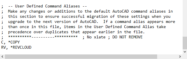

    Always add your alias definitions to the User Defined Command Aliases section at the end of the file even if you are redefining an existing command alias. The last definition in the PGP file is the one the product loads.
  2. Scroll down to the end of the file looking for the section labeled User Defined Command Aliases.
  3. Enter C, *COPY.
  4. Enter RV, *REVCLOUD.
    It should look like the following once you finish.
  5. Save the file.
  6. At the Command prompt, enter REINIT.
    This command loads the latest changes into your current AutoCAD session.

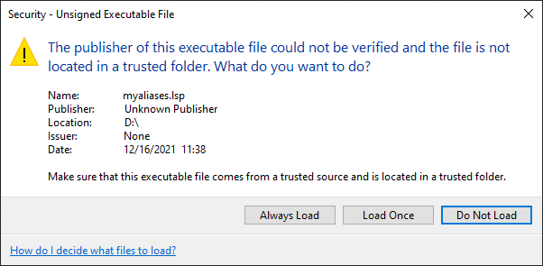

  5. If the File Loading - Security Concern dialog box is displayed, click Load again.

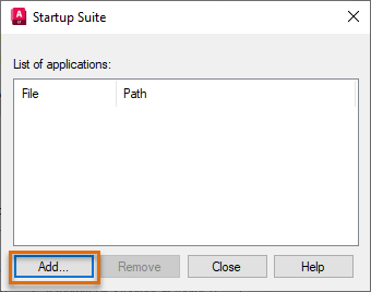

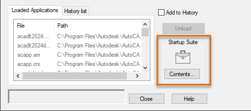

To load your LSP file automatically each time AutoCAD opens, follow these steps.
  1. Click Manage tab > Applications panel > Load Application. Find
    You can also enter APPLOAD at the Command prompt.
  2. Click Contents in the Startup Suite section.
  3. Click Add on the Startup Suite dialog box.

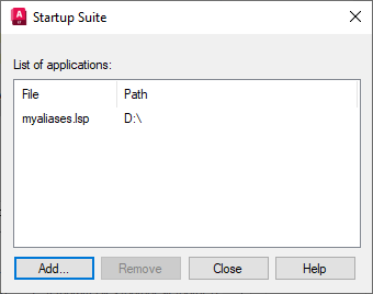

  4. Browse to and select the myaliases.lsp file you created. Click Open.
    The file is added to the Startup Suite.
  5. Click Close on each dialog.
Next time you restart AutoCAD or open a drawing, the LSP file loads automatically and your commands defined in the LSP file are available to use.
Note: You may need to add the folder where you placed your LSP file to the Trusted Locations. Otherwise you will see this alert each time AutoCAD tries to load the file.

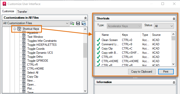

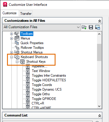

  1. At the Command prompt, enter CUI.
  2. Expand the Keyboard Shortcuts node and the Shortcut Keys node under that.
  3. Select Shortcut Keys.
    This displays a complete list of defined shortcut keys on the right side of the editor.

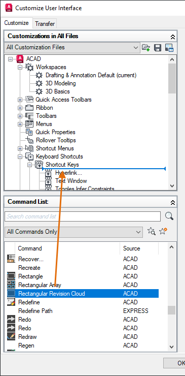

    To define a new shortcut key, we'll drag a command from the Command List to the Shortcut Keys node and then assign a key combination to it.
  4. In the Command List pane, scroll down to Rectangular Revision Cloud.
  5. Drag it to the Shortcut Keys node.
    Tip: While dragging, going outside of the dialog box and then back in to the area you want to place the command eliminates the automatic scrolling. This makes it easier to place the command exactly where you want it.

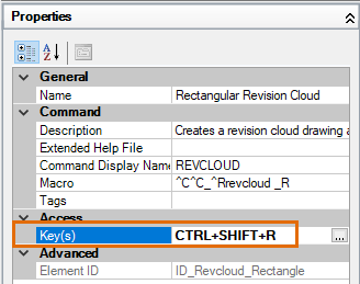

  6. Select the Rectangular Revision Cloud you just added to Shortcut Keys.
    The Properties section is prefilled except for the shortcut keys. We'll assign Ctrl+Shift+R.
  7. In the Properties section, Keys field, do one of the following:
    • Type Ctrl+SHIFT+R.
    • Click ... and press Ctrl+Shift+R on the Shortcut Keys dialog box, and then click OK.
    The result should appear like the following image.
  8. Click OK to exit the Customize User Interface (CUI) editor.
  9. At the Command prompt, press Ctrl+Shift+R.
    The REVCLOUD command runs with the rectangular option.

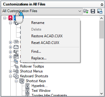

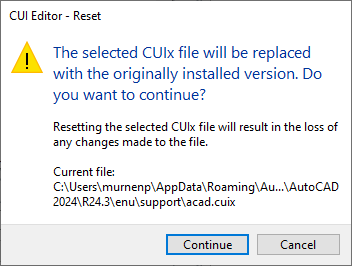

Restore the CUIx File
If you aren't happy with the changes you made, you can restore the CUIx file to either its previous saved state or to the program defaults.
  1. Enter CUI at the Command prompt.
  2. Right-click on the ACAD node in the Customizations in All Files pane (ACADLT node for AutoCAD LT).
  3. Select one of the following:
    • Restore ACAD.CUIX (ACADLT.CUIX for AutoCAD LT) - restores the CUIx to its previous saved state.
    • Reset ACAD.CUIX (ACADLT.CUIX for AutoCAD LT) - resets the CUIx to its original installed state.
  4. Click Continue on the alert.
  5. Click OK to exit the Customize User Interface (CUI) editor.

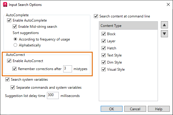

If you frequently misspell certain commands you might want to try AutoCorrect. With the AutoCorrect feature enabled, the command line suggestion list provides suggestions based on misspellings you have made in the past. You can also manually add commands and system variables to the AutoCorrect list that you commonly misspell.
  1. At the Command prompt, enter INPUTSEARCHOPTIONS.
    The dialog box contains a section for AutoCorrect settings.
  2. Select Enable AutoCorrect if it isn't already selected.
  3. Set AutoCorrect to Remember Corrections After 1 Mistypes.
    This is so we can associate a misspelled word with a command in one try in this exercise.
  4. Click OK.

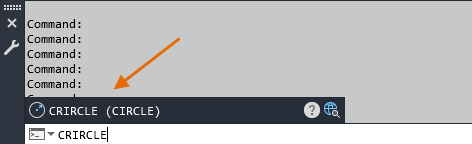

    You can also manually enter commands in the AutoCorrect file.
  13. Click Manage tab > Customization panel > Edit Alias drop-down menu > Edit AutoCorrect List. Find
    Notepad opens the AutoCorrectUserDB.pgp file. The format of this file is INCORRECT, *CORRECT.
  14. Enter CRIRCLE, *CIRCLE on the first empty line.
  15. Click File > Save and close NotePad.
  16. At the Command prompt, enter REINIT.
  17. Select PGP file and click OK.
  18. At the Command prompt, start typing CRIRCLE.
    You can see that it is now corrected and will start the CIRCLE command.
