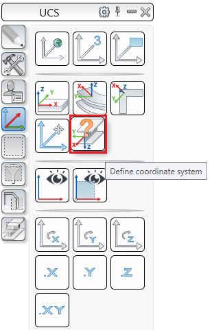

UCS category. The UCS is placed at the start point.
