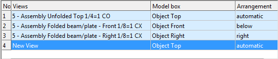

The views created by a selected drawing style are listed in a table.
For each view, a predefined model box and arrangement may be selected. View properties are displayed by double-clicking a view in the table. For more information, refer to View Properties.

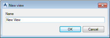

- Enter a name for the new view:
The new view appears in the tree and in the list.
- You can assign a model box and a view arrangement to the new view. This does not affect the original view.

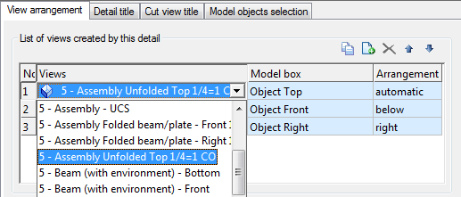

Add an existing view
- On the properties panel, click
(Add existing view).
- Select a view from the tree and click OK. The selected view appears in the tree and in the list. You can assign a model box and a view arrangement to the new view. This does not affect the original view.
