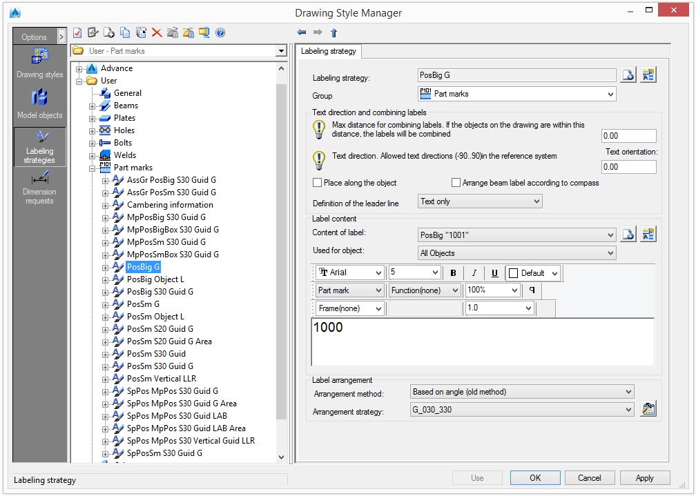

Select labeling strategies from the component panel. The tree panel displays all the labeling strategies grouped by the associated type of object.
In the tree panel, model objects are grouped by Advance object: Bolts, Beams, Welds, etc. A small image depicts the content of the group. All the management functions refer to the labeling strategies.
