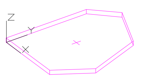

Create polygon plates
The polygon plates are placed in the X/Y plane of the current coordinate system. The plate thickness direction is in the positive Z direction. You can control the Advance default plate thickness, using the Management Tools application.
Access the command
On the Objects tab
Plates panel, click
(Polygon plate).
Command line: _AstM4CreatePolyPlate
- Place a coordinate system with the X/Y plane in the required plate plane.
- On the Objects tab
Plates panel, click
(Polygon plate).
- Select the corner points one after another and press <Enter> when finished.
- The polygon plate is created.
