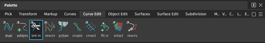

Access this tool from the Curve Edit tool palette:
