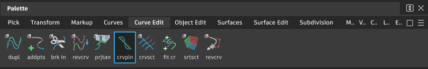

Access this tool from the Curve Edit tool palette:

Set up the Curve Planarize tool
- In the Curve Edit tool palette, select the Curve Planarize tool
, then select the
icon.- To flatten curves onto their average planes, set Default Projection Plane to Best.
