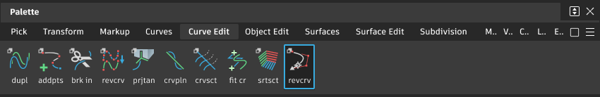

Reverses the parametric (U) direction of a curve, causing the start of the curve to become the end, and vice-versa. This tool also lets you examine the tangent direction on the curve.
Access this tool from the Curve Edit tool palette:
