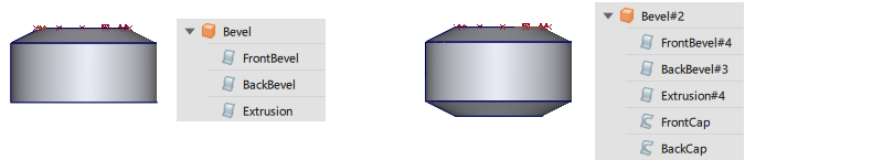

Bevel workflow
The bevel tool creates a group of surfaces:

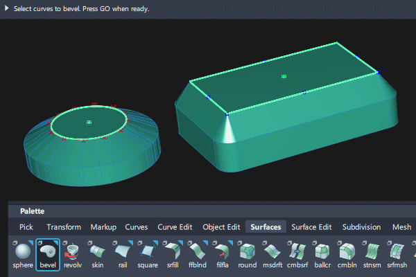

To create a bevelled edge:
  1. Either :
    • Pick the curves or surface edges first, then select the Bevel tool .
    • Or select the Bevel tool first and follow the prompt - pick the curves or surface edges.
  2. Click on the Go button (or use space bar as a short cut).
  3. Do any of the following:
    • Drag the to change the bevel width.
    • Drag the to change the bevel depth.
    • Drag the to change the extrusion depth.
    • Type the bevel width, bevel depth, and extrusion depth separated by spaces to set the values exactly.
    • Or none of these, and the settings in the tool option window will apply.
  4. Click Go to create the surface or use the space bar as a short cut.
