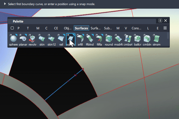

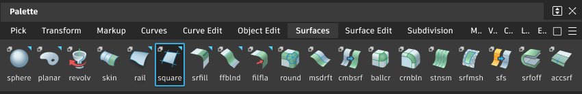

Access the tool from the Surfaces tool palette:

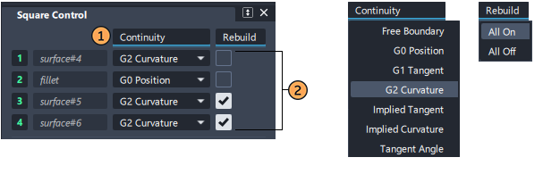

Continuity table and rebuild

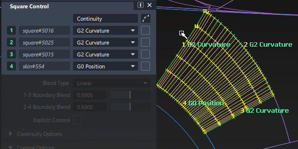

The Continuity table displays one row for each boundary. Use this to select the continuity and rebuild settings:
Use the title pop-up menus to adjust the settings for all 4 boundaries.
Use the pop-up menu and checkbox on each boundary to adjust individually.
Continuity
Select the Continuity you want for each boundary. See Surface Tool Common Parameters for explanations of each continuity option.
Rebuild
The Rebuild option can improve the parameterization of the square surface by attempting to reduce the number of spans while maintaining accuracy to within the Construction Tolerance settings.
Rebuild can help when building from trimmed edges, and when input edges on opposite sides have different degree or spans.

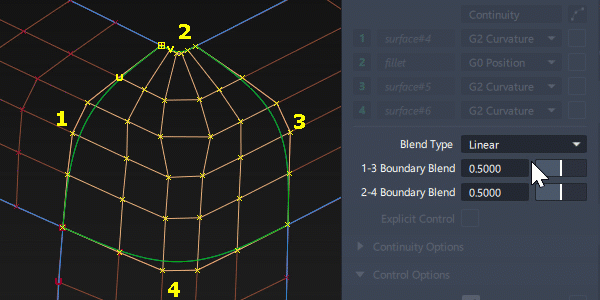

Blend Type
Linear/Cubic
Blending gives you influence over the interior of the square surface. The boundaries are constrained by the input curves and edges.
Use the sliders to nudge the surface towards one boundary shape or the other.
1-3/2-4 Boundary Blend
These sliders control the point of equal influence of opposite boundaries (in other words, the midpoint of the blend between opposite boundaries): that is, between 1 and 3, and between 2 and 4. Values can effectively range from 0.17 to 0.83.

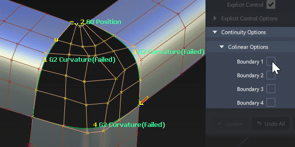

Colinear Options
Boundary 1, 2, 3, 4
When an input boundary has a flow of Hulls and CVs that you want the new square surface to match, use the colinear option. Only applies when G1 Tangent or G2 Curvature continuity is selected for that edge.
Be careful not to use colinear on edges where the CV flow would distort the square surface being built (some trimmed edges for example).
Also be careful not to leave the settings on when moving onto another square surface. If the co-linear options are selected in the wrong circumstances you can get poor results. A good trouble-shooting tactic is to always check that the colinear settings are off, unless you have specifically set them to be on.

Blend Type
Linear – Builds the interior of the surface using only information about the boundary curves. The interpolation of the boundaries is linear. The free CVs of the four boundary curves (CVs not controlled by the continuity options) are blended.
Cubic – Builds the interior using tangent for tangent continuity edges, or tangent and curvature information for curvature edges. The interpolation of the boundaries is cubic when only tangent continuity is needed or quintic when curvature continuity is needed.
Depending on how much the tangent and curvature ribbons change, cubic blends can be much wavier than linear blends.
Example: G1 Tangent continuity along one boundary
Linear blending – Notice that the hull forms approximately a straight line from the third CV row onward.
Cubic blending – The third CV row and onward is rounder and less flat. The Tangent direction (2nd CV row) is being blended into the surface interior.
These sliders control the point of equal influence of opposite boundaries, in other words, the midpoint of the blend between opposite boundaries): that is, between 1 and 3, and between 2 and 4. Values can effectively range from 0.17 to 0.83.
Changing the surface using the Boundary Blend sliders is slow, because continuity must be recalculated. For very complex surfaces, or when using G2 Curvature or Tangent Angle continuity, you may want to turn off the Auto Update option.

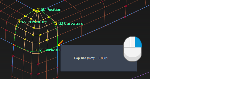

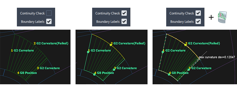

Boundary Labels and Continuity Check
The Boundary Labels are on by default, and they report whether the square surface has achieved continuity to within the Construction Tolerances.
The Continuity Check displays the achieved and failed continuity, using the same colors and decals as the Evaluation > Surface Continuity tool.
Warning arrow
It is quite common for an arrow to appear at a corner, but for the square surface to still build successfully. The arrow is only a warning not an error, and is displayed for information only.
The arrow appears because the Square and Rail tools use an internal G0 tolerance for some computations which is a factor of 10 tighter than your chosen tolerance. The warning arrow will show any tolerance issues at this tighter value.
Right clicking the arrow displays the deviation between the boundaries.

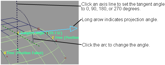

Set a manual tangent angle along an edge
This manipulator only appears when you set an edge to Tangent Angle and the two adjacent edges are set to Free.
- Click an axis line to set the tangent angle to 0, 90, 180, or 270 degrees.
- Click an arc, then drag the mouse left and right to change the angle value, or type a number to set the value exactly.
- When you are finished, click the Go button.
