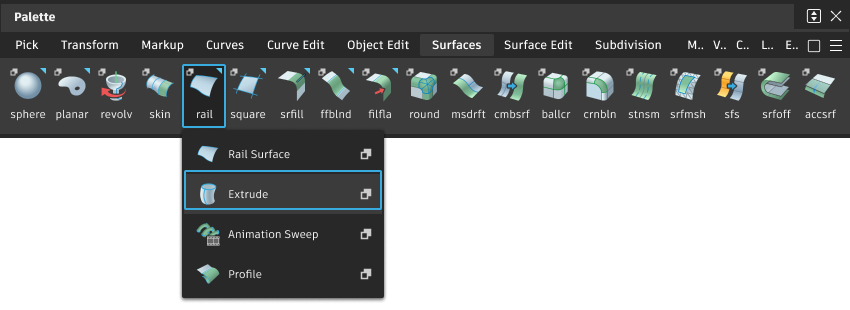

Access the tool from the Surfaces tool palette:

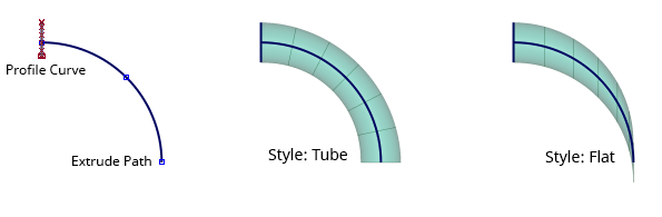

Style
Tube – As the profile curve sweeps along the path, it pivots to maintain the same angle to the path curve.
Flat – As the profile curve sweeps along the path, it maintains its original orientation.

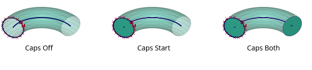

Create caps
Caps can be created at the ends of the surfaces only if the profile shape is a single, closed, planar curve.
Off – Do not create caps at the ends of the extruded surface.
Cap Start – Create a trimmed surface to cap the first end of the extruded surface.
Cap Both – Create trimmed surfaces to cap both ends of the extruded surface.

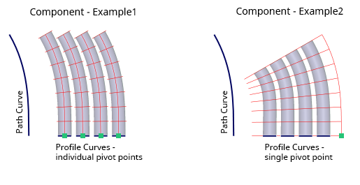

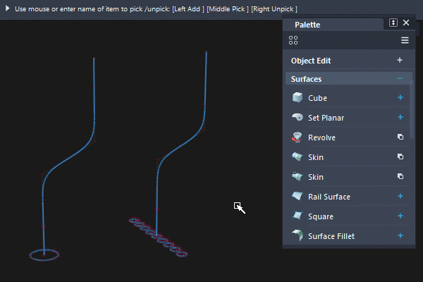

Extrude Pivot
This option only appears when Style is Tube.
The Extrude Pivot defines the position of the sweep path. (The sweep path shape is the shape of the path curve.)
- Closest – The Extrude Pivot is the endpoint of the path curve closest to the bounding box of all the profile curves. This is best illustrated with multiple profile curves:
- Component – The Extrude Pivot is at the pivot point of each profile curve.

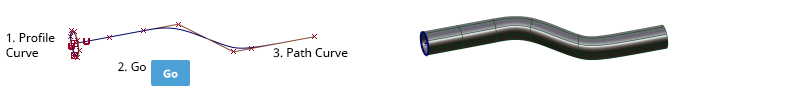

Create a simple extrude
You will get the most predictable results if you position the profile curve at the start or end of the path curve.
If you have many profile curves and want to drag-select them, do this before choosing the Extrude tool.
- Either select the profile curves first, or the Extrude tool first.
- When all the profile curves are highlighted, click the Go button.
- Pick the path curve to extrude along.

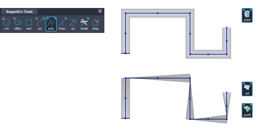

What can extrude do that Rail and Profile can't?
If a path curve has tangent breaks (for example a poly-line from the Keypoint Curve toolbox), the Extrude tool is the only tool that will sweep a profile successfully along it, creating sharp mitred corners.
It is recommended that you use Object Edit > Detach to split the resulting surface at the sharp breaks if you want to continue further modeling.
