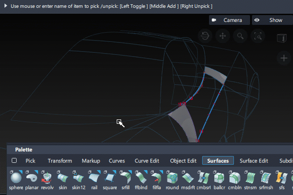

Create a surface by calculating the area swept out by a generation curve moving along one or more rail curves. You can use one generation curve or blend between two or more generation curves.

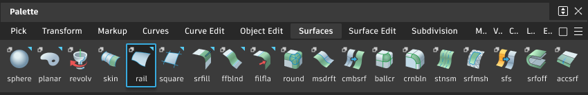

Access this tool from the Surfaces palette:

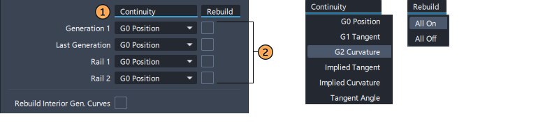

Continuity table and rebuild
The Continuity Table displays one row for each boundary. Use this to select the continuity and rebuild settings:
Use the title pop-up menus
to adjust the settings for all 4 boundaries. Use the pop-up menu and checkbox
on each boundary to adjust individually.
Continuity
Select the Continuity you want between each boundary of the rail surface and the adjacent surface. See Surface Tool Common Parameters for explanations of each continuity option.
Rebuild
The effect of turning rebuild on or off can be difficult to predict, and can sometimes make the surface parameterization worse rather than better.
Most users quickly experiment with different combinations to find the best result. The following are guidelines for finding the best settings for rebuilding the input boundaries:
Typically don't use Rebuild on a well-parameterized natural surface or curve input boundary.
Try using Rebuild On for trimmed edges.
Try using Rebuild On when opposite edges have different parameterization.
Rebuild On is is necessary for rail curves with multi-knots or CV weights, and recommended for generation curves with multi-knots or CV weights.

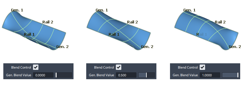

Blend Control (2 generation curves only)
Blend Control modifies the influence of the generation curves over the rail surface shape.
Selecting Blend Control displays the Gen. Blend Value slider to control the midpoint of the blend between two generation curves.(the point where the influence of both generation curves is equal).
The default value is 0.5 which blends the two curves equally, so that the halfway point of the blend occurs at the midpoint of the rails.
Moving the slider towards 1 gives the Gen. 1 shape a stronger influence.
Moving the slider towards 0 gives the Gen. 2 shape a stronger influence.
The values 0.0 and 1.0 still blend the two curves a minimum amount.

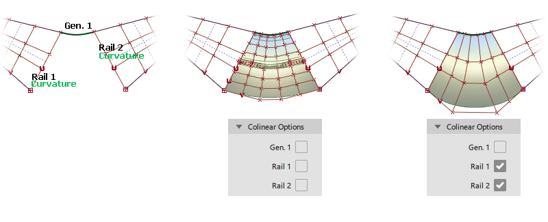

Colinear Options
Select the boundaries where you want alignment with the hulls of the adjacent surface (when using G1 Tangent or G2 Curvature continuity).
Be careful not to use colinear on edges where the CV/hull flow would distort the rail surface being built.

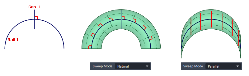

Sweep Mode
Natural – As the generation curve sweeps along the rail, it pivots to maintain the same angle relative to the rail curve.
Parallel – As the generation curve sweeps along the rail, it maintains its original orientation.

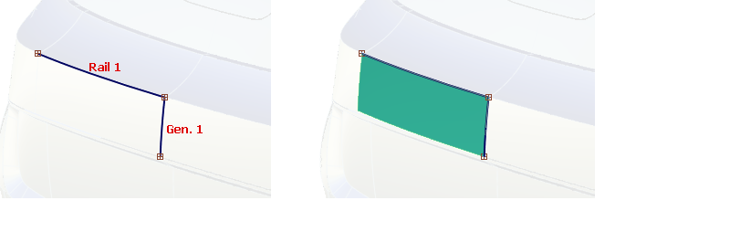

For a mono-rail sweep, the generation shape must connect with the rail curve as it is swept.
If the gen. curve is drawn in the required starting position for the surface, touching rail curve, then the sweep pivots don’t need to be considered and the Closest setting will give the expected results:

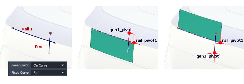

Sweep Pivot: On Curve
Sweep Pivots are displayed on the input curves, one on the Generation and another on the Rail. These can be positioned along each curve by dragging the locator. The pivot labels are only displayed once a pivot is selected.
When the sweep surface is built, the two pivot points become coincident, by moving either the gen. or the rail curve shape depending on the setting for Fixed Curve.

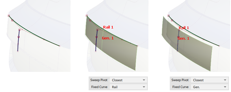

Fixed Curve
This option determines which input curve is free and which is fixed if the curves are not touching.
- Gen – The generation curve position is fixed, and the rail curve shape is moved.
- Rail – The rail curve position is fixed, and the generation curve shape is moved.

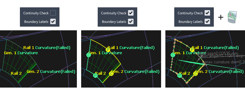

Boundary Labels and Continuity Check
The Boundary Labels are on by default, and they report whether the square surface has achieved continuity to within the Construction Tolerances.
The Continuity Check displays the achieved and failed continuity, using the same colors and decals as the Evaluation > Surface Continuity tool.

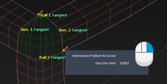

Warning Arrow
It is quite common for an arrow to appear at a corner, but for the rail surface to still build successfully. The arrow is only a warning not an error, and is displayed for information only.
The arrow appears because the Rail (and Square) tools use an internal G0 tolerance for some computations which is a factor of 10 tighter than your chosen tolerance. The warning arrow will show any tolerance issues at this tighter value.
Right mouse clicking on the arrow displays the deviation between the boundaries.
