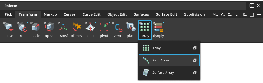

Duplicates one or more objects and places the copies at equal distances along one or more curves, creating stitch patterns.
Access this tool from the Transform tool palette:

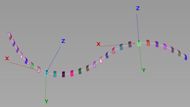

Orientation
None – No change in orientation.
Tangent – The first copy of the object takes the original orientation and all subsequent copies are rotated based on the tangent of the input curve at the point where the object is being placed. This allows the arrayed objects to follow the flow of the input curve.
Normal – Aligns the local X axis of each duplicate with the tangent of the target curve at the position of the duplicate. If the target curve is a curve-on-surface, each duplicate is oriented so that its local Z axis matches the normal direction of the surface where the curve-on-surface lies. If the target curve is a free curve, the Z axis of each duplicate is oriented along the direction of the curvature vector of the curve (like plot combs).
Note: If the curvature of the curve changes direction, the duplicates orientation does not flip at inflection points.
