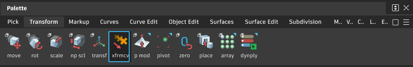

Access this tool from the Transform tool palette:

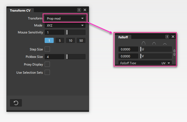

Transform CV settings

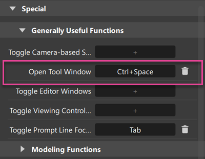

Tip: Starting in Alias 2025.1 Update, you can assign Ctrl + Spacebar as a hotkey to open the Transform CV options window. To do this, open the Hotkey Editor (Preferences > Hotkeys/Menus Editor) and go to Special > Generally Useful Functions > Open Tool Window.

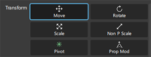

Transform
Choose the kind of transformation you want to apply to the selected CVs, edges, and faces.
  • Move – Move CVs relative to their curve or surface, along a given vector or reference plane, in the plane of the current view, or in the X, Y, or Z direction.
  • Rotate - This tool behaves like the Transform tool of the same name, rotating CVs around the object’s rotation pivot point.
  • Scale – This tool behaves like the Transform tool of the same name, scaling CVs proportionally along all 3 axes, with respect to the object’s scaling pivot point.
  • Non P scale – This tool behaves like the Transform tool of the same name, scaling CVs by different amounts along each axis, with respect to the object’s scaling pivot point.
  • Pivot – This tool behaves like the Transform tool of the same name, positioning the object’s pivot points. It uses the options from Set Pivot to determine which pivot(s) to move (Rotation, Scaling, or both).
  • Prop Mod – This tool behaves in a way similar way to the Proportional Mod tool but its interface is more intuitive and easily allows experimentation with falloff values. When Transform is set to Prop Mod, a Falloff window displays allowing you to set falloff values in the U and V directions.
    Tip: Resize the Falloff window by dragging a window border.

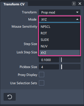

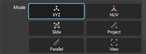

Mode
When Transform is set to Move or Prop Mod, additional Mode options are available.
  • XYZ - Moves CVs along the X, Y, Z world axes. The mouse buttons operate the same as in the Transform > Move (or Transform > Modify > Modify > Proportional Mod) tool.
  • NUV - Moves CVs along the normal, or in the U or V direction on a surface, using the LMB, MMB, and RMB respectively.

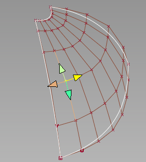

  • Slide - Moves CVs along their respective hull. For Prop Mod, the arrows only appear around the primary CV.
  • Project - (applies to Move only) Moves CVs in the direction of a hull line, a vector, or constrains the movement to a reference plane.
  • Parallel - (applies to Move only) Moves CVs parallel to a vector or hull line without snapping to it.
  • View - (applies to Move only) Moves CVs in the plane of the current view.
    • LMB - Unconstrained movement in the current plane defined by the direction of the view.
    • MMB - Movement constrained to the horizontal axis of the screen.
    • RMB - Movement constrained to the vertical axis of the screen.
    • Rotate – (applies to Prop Mod only) Rotates CVs relative to their proximity to a center "master" CV.
    • Non P Scale – (applies to Prop Mod only) Non-proportionally scales CVs relative to their proximity to a center "master" CV.

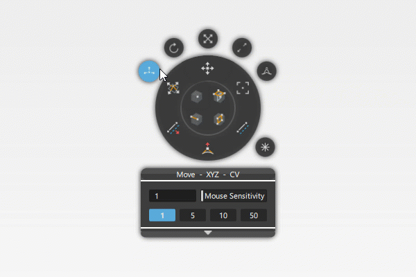

Work with the Transform CV puck
When the Transform CV tool is selected, holding down the Spacebar displays an in-canvas puck interface under the cursor.
The transform tools are available in the horizontal ribbon, and the different modes that apply to the selected tool are displayed on the wheel. The center spot is divided into four pick types: CV, Edge, Edge Loop, and Face. The check box options appear on the sides, while the sliders and buttons are at the bottom. Hover over an icon to see the option name.
How to use the Transform CV puck interface
  1. Choose the Transform CV tool.
  2. Press and hold down the Spacebar.
    The puck interface appears
  3. Click on a tool (on the ribbon) to select it.
  4. Click on a mode (if available on the wheel) to select it.
  5. Click on the pick type icon (in the center spot), depending on what you want to manipulate.
  6. Release the Spacebar.
    The puck interface disappears.
  7. Pick the CV(s), edge(s), or face(s) and drag. If the CVs are not visible, clicking on a curve or surface displays them.
    Note: If the CVs you want to transform are part of a selection set, turn on Use Selection Sets.
  8. To adjust the pickbox size, or mouse sensitivity, hold down the Spacebar to bring back the hotspot interface, and adjust the sliders.

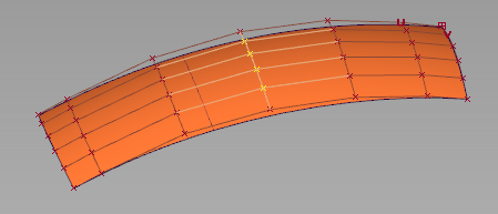

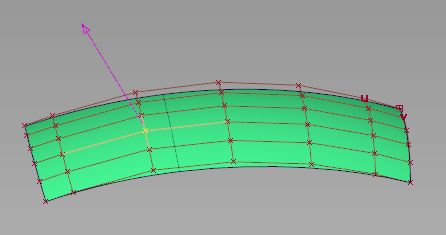

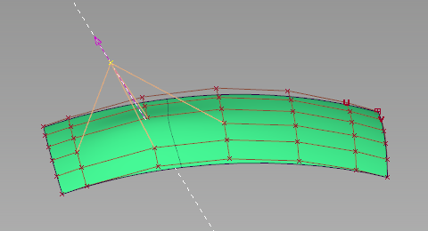

  1. Shift-select the Transform CV tool.
  2. In the Transform CV window:
    • Choose Move from the Transform list.
    • Choose NUV from the Mode list.
  3. Pick the CVs you want to move. To select additional CVs, hold Shift and click them.
  4. Drag a mouse button to move the CVs:
    • Drag the LMB to move along the normal.
    • Drag the MMB to move along the U direction.
    • Drag the RMB to move along the V direction of a surface.
      Moving four CVs along the surface normals.
Note: The Move CV Normal tool in the Transform palette works in a similar fashion.

  3. Click the CV you want to move. To select additional CVs, hold Shift and click them.
  4. Click the arrow on the hull/edge you want to move the CVs along, then drag to move the CVs.

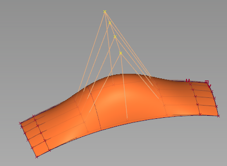

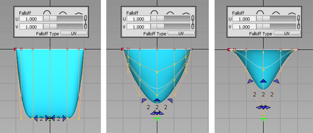

Transform one CV and have surrounding CVs follow it
How to move (in space, or relative to the geometry), scale, or rotate multiple CVs at once, with the amount of transformation relative to the CVs distance from the primary CV you click.
  1. Shift-select the Transform CV tool to open the Transform CV window.
  2. In the Transform CV window choose Prop Mod from the Transform list.
  3. Choose a mode from the Mode list.

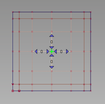

  4. Select the primary CV. All other CVs will move with respect to this CV.
    Note: If the CVs are not visible, click on the object and they will be displayed automatically.
    A green jack locator apears on the CV, and eight blue arrows appear around it.
  5. Select the range of CVs that you want to transform, by doing one of the following:
    • Click on the blue arrows to select/deselect rows of CVs.
    • Hold down the Shift key, and click on a CV (or box-select) to select/deselect additional rows.
      A numeric label shows how many rows of CVs have been selected in each direction. Selecting and deselecting CVs always maintains a "rectangular" selection.
  6. In the Falloff window, adjust the falloff values in the U and V direction. By default the sliders are synchronized. To decouple them, click the chain link icon.
  7. Drag to transform the CVs. The mouse buttons operate in the same way as for the Move transformation.
    Set Transform to Pivot if you need to move the pivot before rotating or scaling CVs. The options from Transform Local Set Pivot are used to determine which pivot(s) to move (Rotation, Scaling, or both).
  8. Modify the falloff values, mode, range of CVs, or even the primary CV itself. The other parameters are maintained. You can even change the Transform option and come back to Prop Mod without losing your settings.
    Note: All with all other Transform CV applications, Mouse Sensitivity and Step Size can be used with this Prop Mod tool.
Note: You can also use the puck interface to switch between options in order to reduce mouse movement across the screen. To see this interface, hold down the Spacebar while in the Transform CV tool.

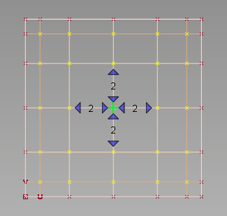

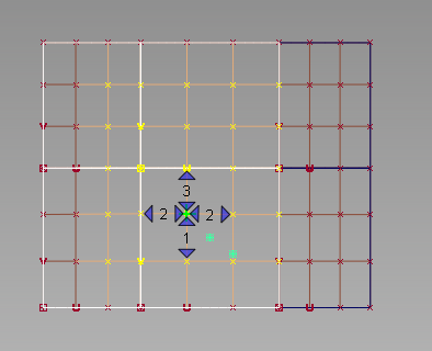

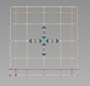

Specify the selection range
You must first select the primary CV by clicking on it. The primary CV defines the point from which falloff is calculated and applied to the range of CVs. It is indicated by a green jack locator.
If only one CV is selected when the Prop Mod tool is invoked, it becomes the primary CV.
Note: If the CVs are not visible on the object, clicking it first will turn on the hull and CVs.
Small blue arrows appear around the primary CV, allowing you to select/deselect additional rows of CVs to define the range that will be affected by Prop Mod.
  • Click an outward pointing arrow to add CVs to the range in the given direction.
  • Click an inward pointing arrow to remove CVs from the range in the given direction.
If you keep the mouse button depressed, rows of CVs are continuously added/removed to/from the selection. if you click and release, rows are added/removed one at a time.
A numeric label shows how many rows of CVs have been selected for each direction.
Selecting and de-selecting CVs always maintains a “rectangular” selection.
Instead of using the blue arrows, you can also select the range of CVs by holding down the Shift key, and:
  • Box-selecting the entire range.
  • Selecting the CVs at the extent of the range. The intermediate CVs are added to the range.
  • Selecting already selected CVs to de-select them along with all CVs on the same hull lines and those further away.
Note: The CV selection is retained when changing modes within the Prop Mod tool. However, changing tools deselects all the CVs.

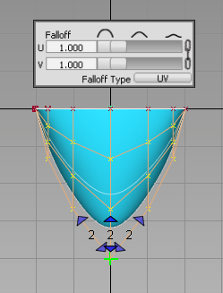

Adjust the falloff values
The falloff window appears as soon as the Prop Mod tool is selected.
As with the Proportional tool, we use a range-based modification. When Falloff Type is set to UV, the falloff is calculated by counting the number of CVs from the primary CV. The greater the number of CVs between the primary CV and the boundary of the defined region, the less effect the transformation has on each CV. When Falloff Type is set to Dist, the falloff is calculated based on the distance from the primary CV.
By default the U and V falloff sliders move in sync. To decouple them, click the chain link icon on the right hand side of the window. A value of 0.0 means that all CVs move by the same amount. A value of 1.0 (default) corresponds to a linear falloff. The higher the falloff value, the less effect the movement of the primary CV has on the surrounding CVs.
Changing the falloff values automatically causes the last Prop Mod transformation to update to the new falloff values.
The slider settings are maintained between applications of the tool.
The Prop Mod arrows take priority over the number boxes.

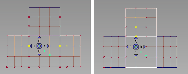

Apply Prop Mod across multiple surfaces
Under certain conditions, it is possible to select CVs on surfaces adjacent to the surface containing the primary CV and apply the modification across several surfaces:
  • The surfaces must share an edge along its full length.
  • Adjacent CVs must match (within G0 continuity tolerance).
Examples
In Figure A below, you can only select CVs across adjacent surfaces in a single direction.
In Figure B, the surfaces form a rectangular grid, allowing you to expand the selection to adjacent surfaces in both directions.
Figure A: Four adjacent surfaces.
Figure B: Six adjacent surfaces forming a rectangular grid.
