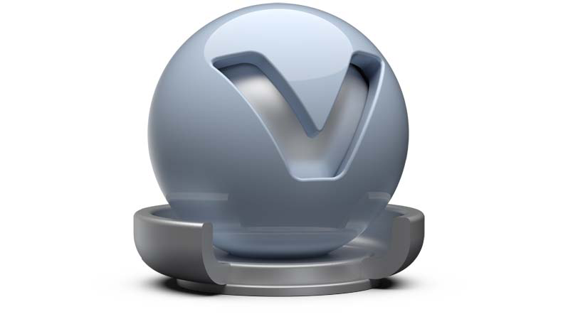

This material generates a single-colored car lacquer material with customizable coating effect on the top of the surface.
Unicolor Carpaint Material
