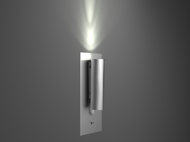

Photometric lights use data measured from real-world lights, often directly from bulb and enclosure manufacturers themselves. You can import IES profiles from companies such as Erco, Lamp, Osram, and Philips; their IES files provide accurate intensity and spread data for a given light model.
