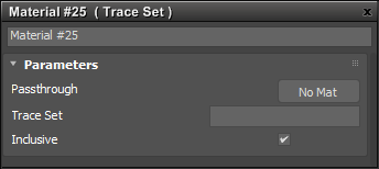

It is possible to designate objects to be part of one or many trace sets. The trace_set shader marks specific rays with an inclusive or exclusive trace set.

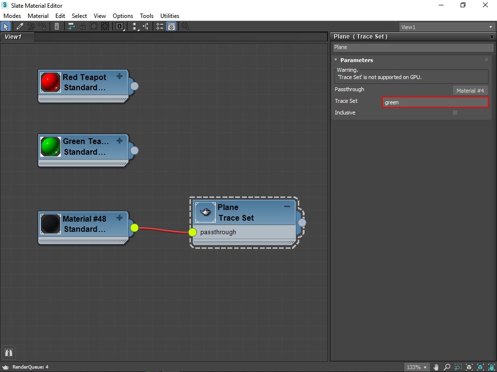

trace_set set to green for shader and plane object (inclusive: disabled).

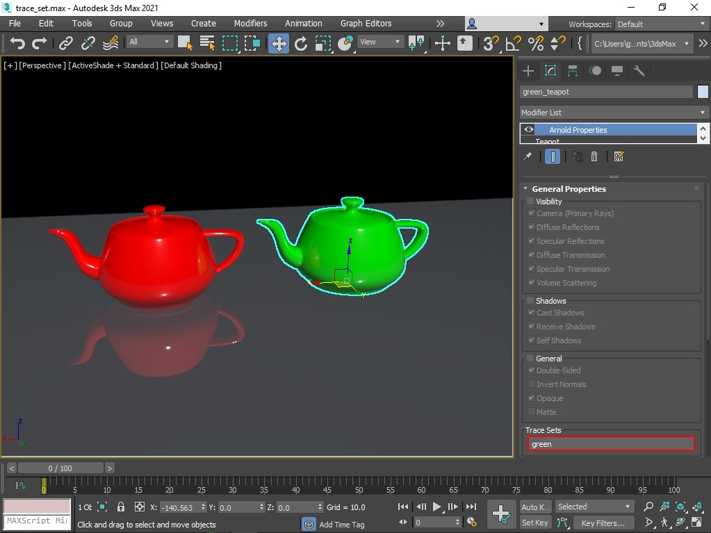

In the General Properties of the Arnold Properties Modifier, it is possible to tag objects to be part of one or many trace sets.
