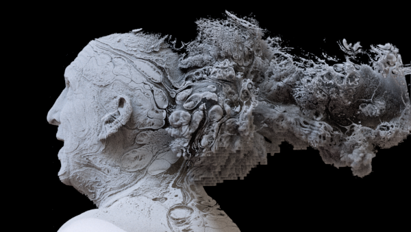

Polymesh to Volume tutorial - Arnold for 3ds Max

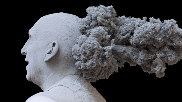

Polymesh objects can be rendered as volumes. This gives many creative opportunities for rendering solid objects in varied and interesting ways. This short 'making of' tutorial shows how to combine a polymesh with an Arnold Volume by combining their shading using the Standard Volume Displacement.

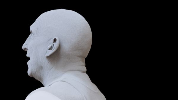

Polymesh rendered as a volume
You must add a Step Size value and assign a Standard Volume shader for the mesh to render as a volume.

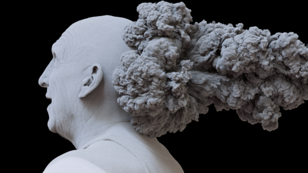

Volume
  • Next, place an Arnold Volume at the rear of the head and assign the same Standard Volume shader to it. In this case, a smoke .vdb file was used.
Alternatively, you could use a different mesh and apply the same shader as the head to it. The aim is to have something that looks complex for the displacement texturing process.
Volume rendered with same Standard Volume shader

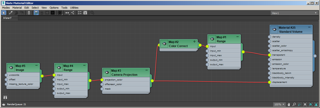

Displacement Texture (Standard Volume Shader)
  • Connect a file texture to the displacement attribute of the Standard Volume shader. In this case, a camera projection has been used. We can see the effect of the texture (mostly on the head), however, we need to make the effect more prominent.
Displacement texture is faintly visible
Range Shader
  • We can use a Range shader to remap the input values of the file texture to exaggerate the effect. Connect the file texture to the Input of the Range shader and connect the Range shader to the Standard Volume Displacement. Increase the Output Max value of the Range shader to around 8. You should now start to really see the effect that the file texture has on the Volume Displacement.
Displacement texture is more obvious due to Range shader

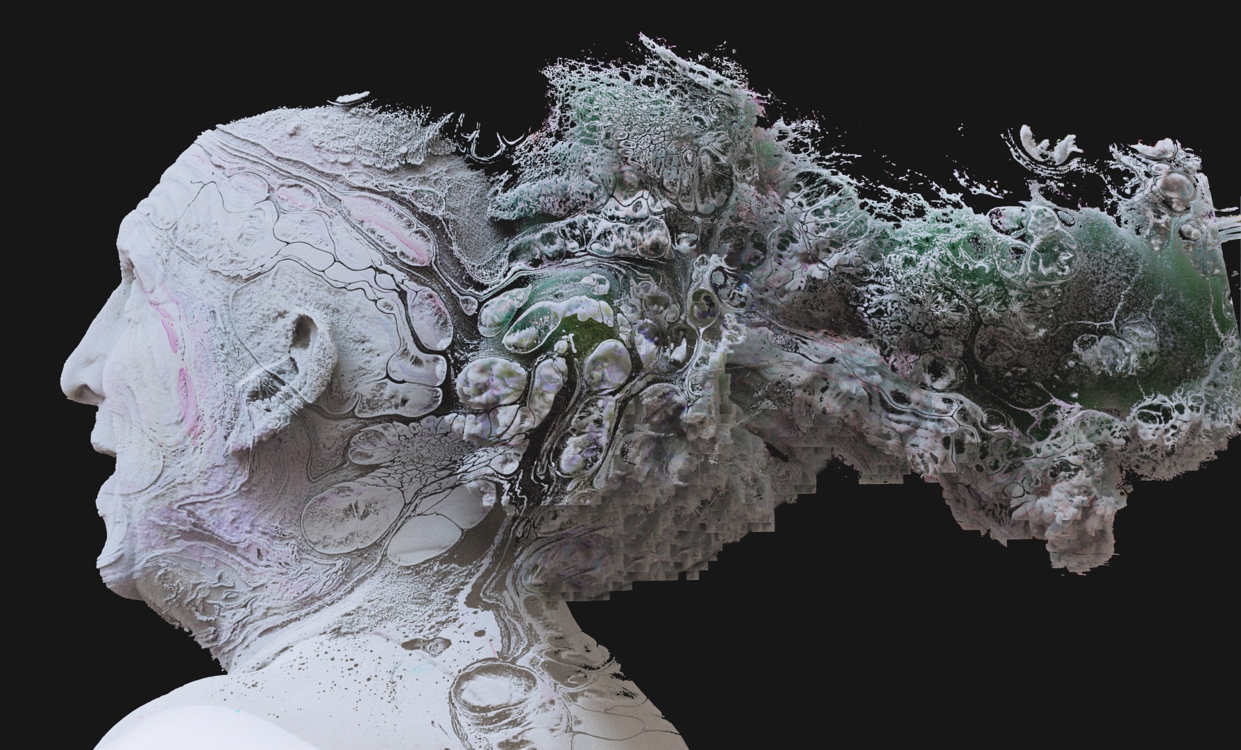

  • Finally, to add some color, you could try connecting the same file texture to the Scatter Color or Transparent Weight attributes of the Standard Volume shader.
Final shading network
