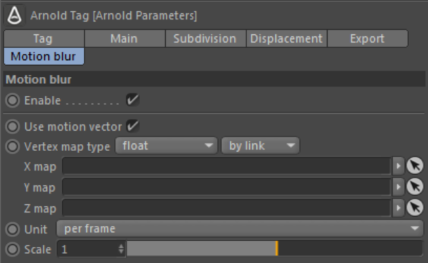

Enable
Enable/disable motion blur by the object.
Use Motion Vector
When enabled the motion blur will be calculated using a velocity vector defined by vertex maps.
Vertex Map Type
Specifies the type of the vertex map used, which can be a color map or three float maps (X, Y, Z channels).
You can also specify if the vertex maps are assigned by link or by name.
  • By link: you have to drag & drop the vertex maps of the motion vector channels to the link fields. This mode can be used if the maps are visible in the object tree.
  • By name: this mode is useful when the object is a generator and the maps are generated to the polygon object, so they are not visible in the object tree.
X,Y,Z map / Vector map
The map(s) which define the velocity per vertex. For instance the point vector attribute coming from Houdini, may be called v_1, v_2, v_3.
Unit
Specifies if the velocity is interpreted as a 'per frame' or 'per second' value.
Scale
A float scale field (with a default value of 1) to do time scaling effects.

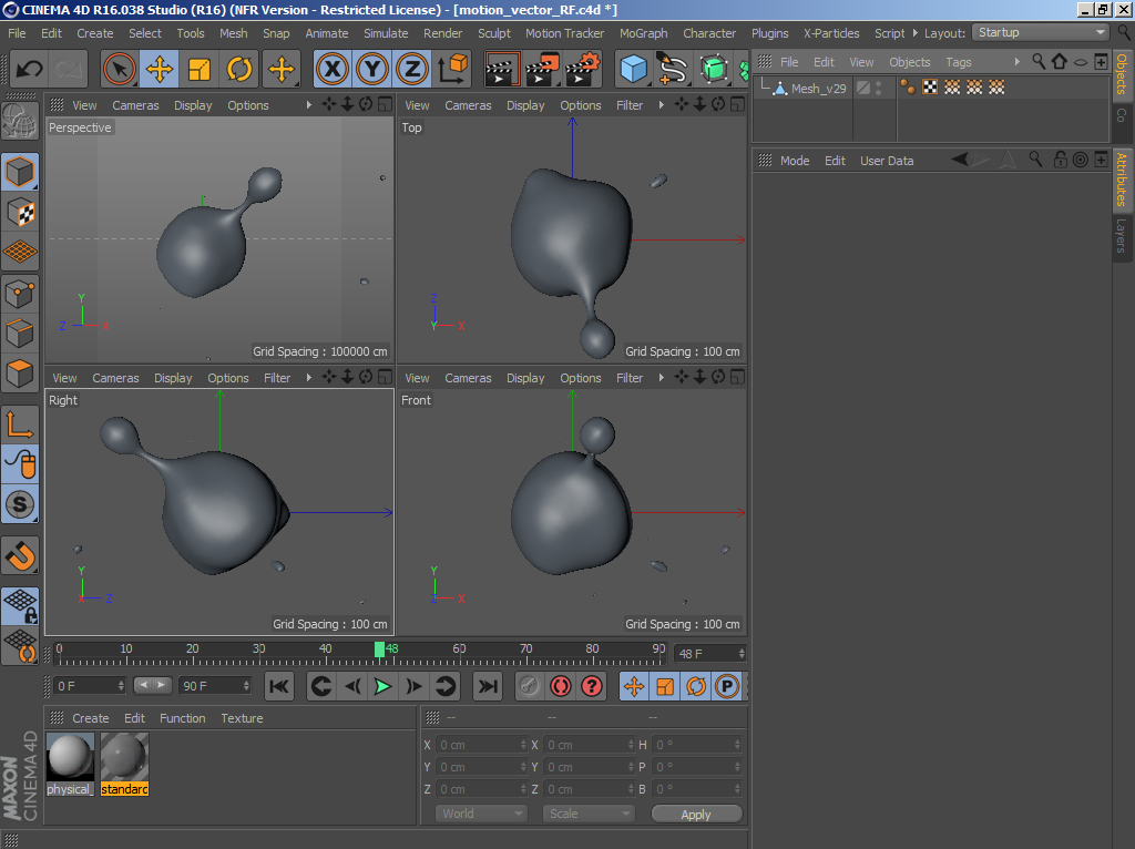

In this example we will use a scene that has been exported from RealFlow with velocity point vertex data. In C4DtoA we can use motion vectors to apply motion blur settings to the fluid.

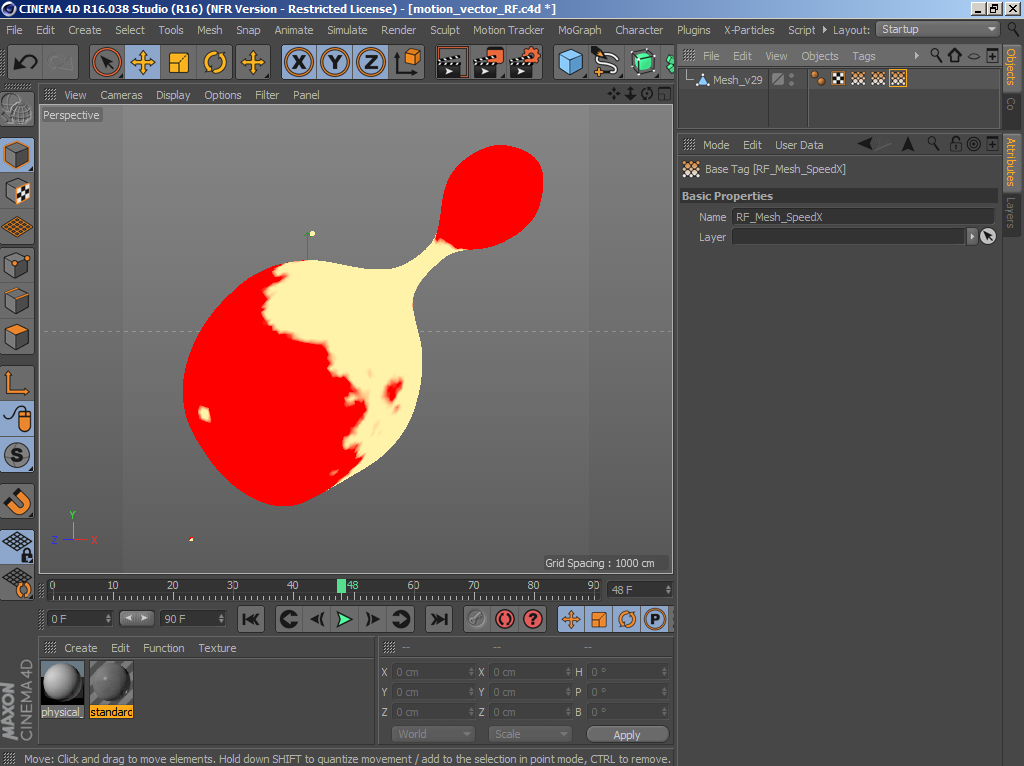

  • Select the Vertex Map Tag in the Object Manager to view the X, Y, Z velocity maps in the viewport.

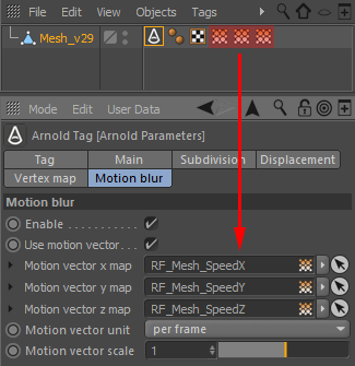

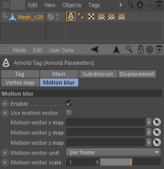

  • Add an Arnold Tag to the mesh and go to the Motion Blur tab.
  • Drag and drop the Vertex Map Tags from the Object Manager onto the respective X, Y and Z Motion vector map fields below and enable 'Use motion vector'.
    Note:
    Make sure that the vertex maps are exported. You can go to the Vertex Map tab to check the settings. All vertex maps are exported by default.

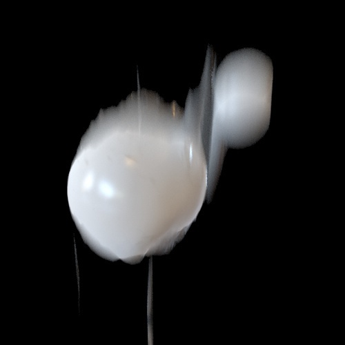

  • Increase the Motion Vector Scale to exaggerate the motion blur effect when rendering.
    1 10

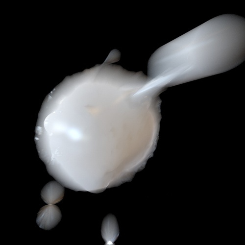

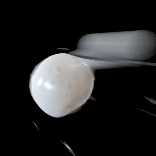

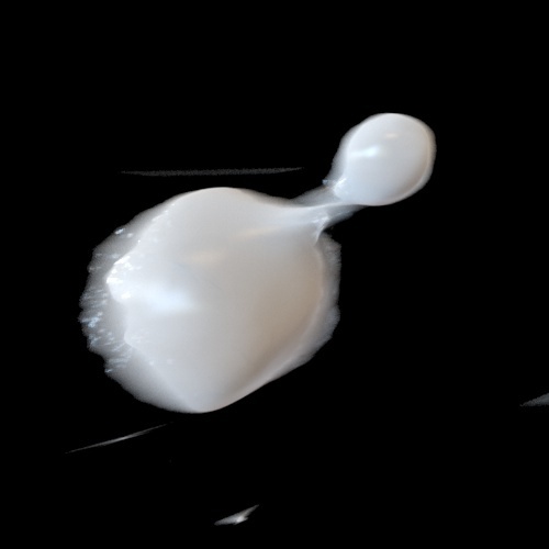

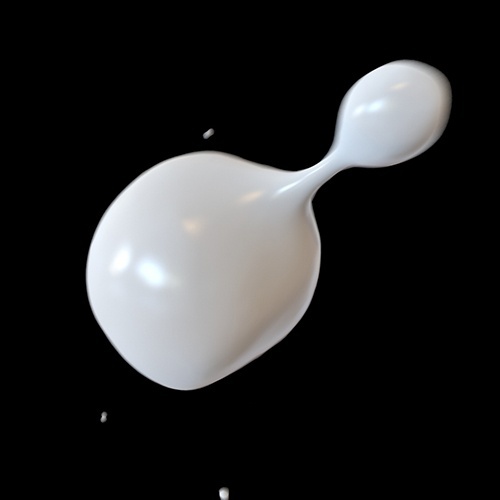

  • Below you can see the results when rendering each motion vector map independently.
    motion_vector X Map motion_vector Y Map motion_vector Z Map
