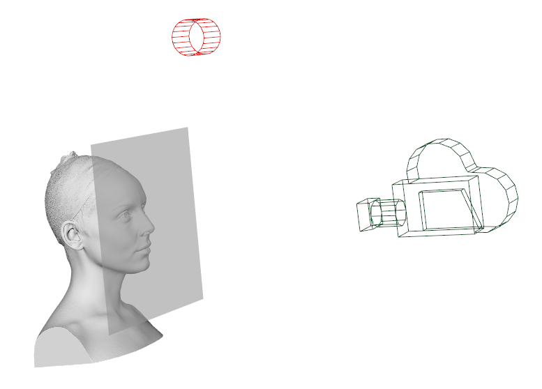

Scene Setup
  • Import the head model into the scene.
  • Create a Cylinder or Quad area light and position it above and slightly in front of the head model. Increase the lights Exposure to around 4.
  • Create a polygon plane and position it in front of the head. We will use this plane to refract the rest of the head using the same texture map.
  • Create a camera (rename it RenderCam) and position it so that it is pointing at the front of the head.

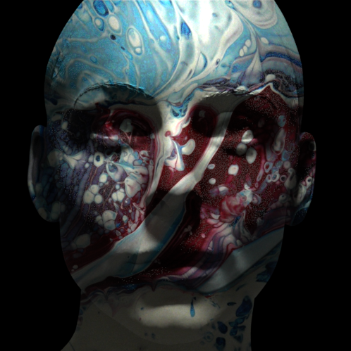

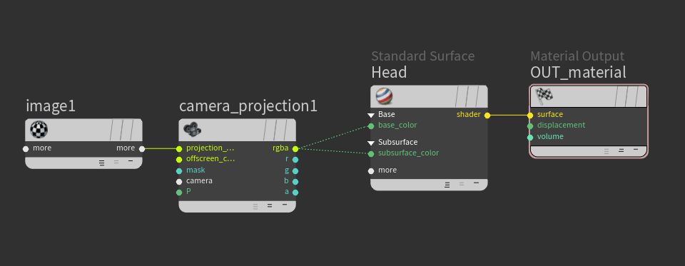

Head Shader
  • Assign a Standard Surface shader to the head model.
  • Create a Camera Projection shader and connect it to the Base Color and Subsurface Color of the Standard Surface shader.
  • Create an Image shader. Open the texture file in the image shader. Be aware that some images work better than others. It helps if you use an image with a lot of contrast. It will give more variation in the refraction, which will give the effect that the head is distorting and breaking up more.
  • Connect the Image shader to the Projection Color of the Camera Projection shader.
  • In the Camera Projection shader, choose RenderCam in Link to Camera (under Camera).

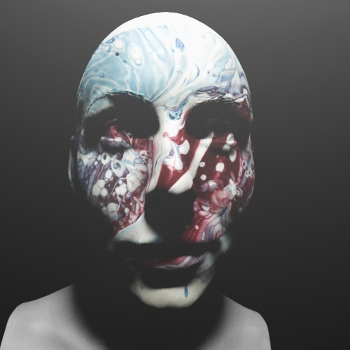

Head model render (without plane)
Head shader

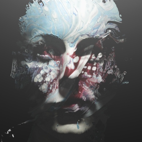

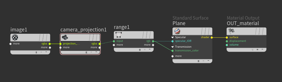

Plane Shader
  • Create another Standard Surface shader and assign it to the plane.
  • Increase the Transmission Weight to around 0.9.
  • Connect the same projected texture to the Specular IOR and Transmission Color via a Range shader. The Range shader is used to define how much the texture will refract and can be used to fine-tune the effect.
  • Increase the Output Max of the Range shader to around 6 and the Input Max to around 2. Try experimenting with the other values of the Range shader to get interesting effects.

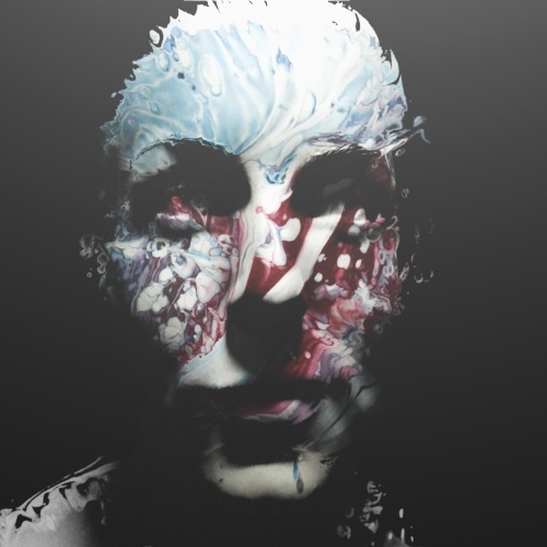

Output Max: 0 Output Max: 1 (default) Output Max: 6

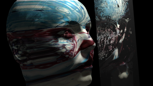

Plane refracting head behind it
Plane shader
