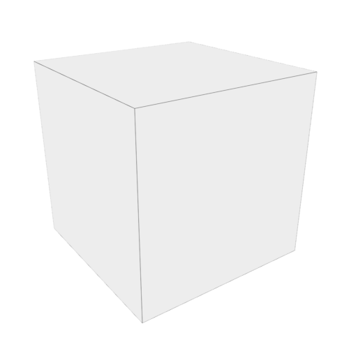

The following examples have been shaded with the utility shader in polywire mode.
Type
This enum. Defines the subdivision rule that will be applied to the polymesh at render time. Possible values are catclark (catmull clark) and linear.
None
Ignores any subdivision and renders the mesh as it is.

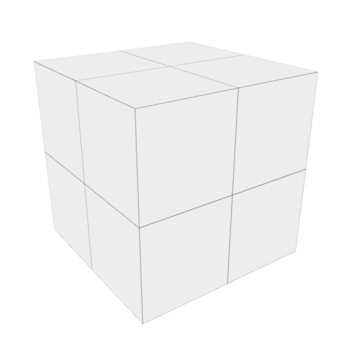

Linear
Linear subdivision puts vertices in the middle of each face.

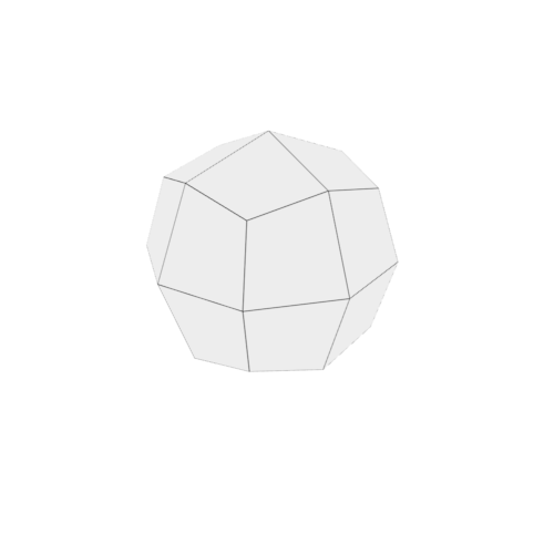

Catclark
The Catmull-Clark algorithm is used to create smooth surfaces by recursive subdivision surface modeling. The resulting surface will always consist of a mesh of quadrilateral faces.
| none | linear | catclark |

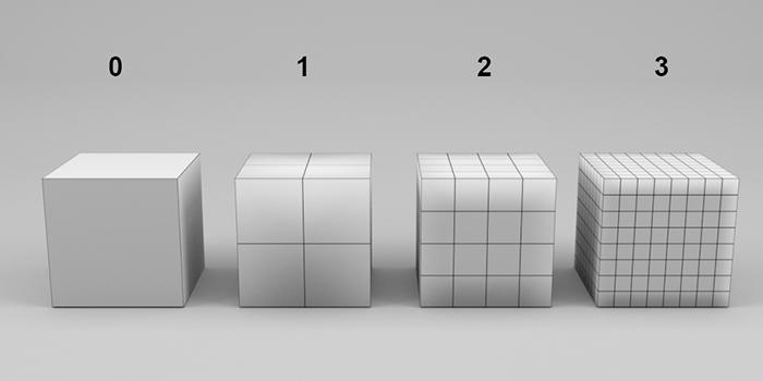

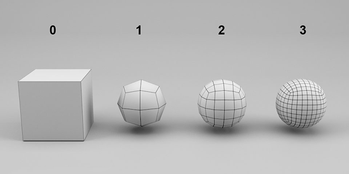

Iterations
The maximum number of subdivision rounds applied to the mesh. When subdiv_pixel_error is 0 the number of rounds will be exact instead of a maximum.
Bear in mind that each subdivision iteration quadruples the number of polygons. If your object has 2 levels of subdivision iterations set and 4 additional iterations set in Arnold, that's 6 subdiv iterations total and therefore 426936 * 4^6 = 426936 * 4096 = 1.7 Billion polygons.
| subdivision_type: linear | subdivision_type: catclark |
Care should be taken when increasing Arnold's subdivision iterations in combination with Maya's Smooth Mesh Preview (3 on the keyboard). Arnold will also render this preview s moothed state in the final image. This may result in a subdivided mesh that far exceeds the necessary amount of polygons required and will result in longer export/render times.

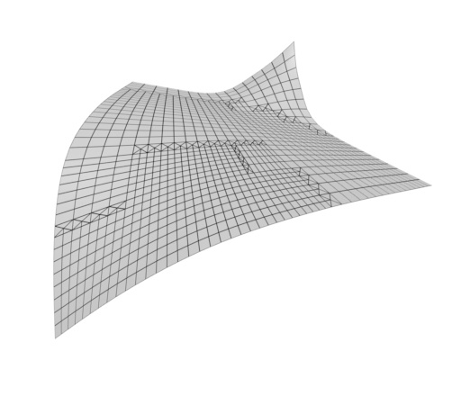

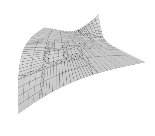

Adaptive Metric
The metric used to determine the amount of error between a given subdivision level and the limit surface.
- edge_length: no final edge will be longer than subdiv_adaptive_error.
- flatness: the distance to the limit surface will be smaller that subdiv_adaptive_error.
- auto: in general, flatness will produce better approximation for the same number of tessellated triangles. But since subdivision tessellation does not take into account displacement, "flatness" might stop way too early and miss a lot of displacement detail (think of a displaced plane: a single quad will represent the plane exactly, but will not have enough vertices to show the displacement's detail). To avoid this issue "auto" uses the "edge_length" metric if the polymesh has a displacement shader assigned, otherwise, it will use the "flatness" metric.
| non-adaptive | flatness | edge_length |
Adaptive Error
The maximum allowable difference for the chosen metric (subdiv_adaptive_metric) in the chosen space (subdiv_adaptive_space). The smaller the error, the closer to the limit surface a mesh will be and the less inter-frame "popping" when the subdivision level jumps, at the expense of using more polygons. A value of 0 disables adaptive subdivision, reverting to uniform subdivision, which can be more stable in animation. Examples:
- a value of 1.0 with subdiv_adaptive_space set to "raster" and subdiv_adaptive_metric set to "edge_length" will subdivide until all edges are shorter than 1 pixel.
- a value of 1.0 with subdiv_adaptive_space set to "object" and subdiv_adaptive_metric set to "flatness" will subdivide until the tessellation is closer than 1 unit in object space to the limit surface.
See examples here.

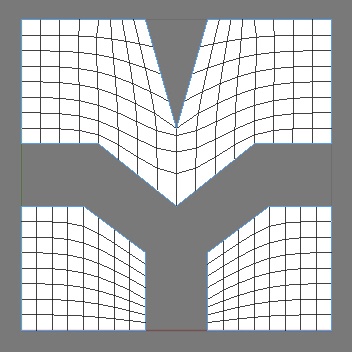

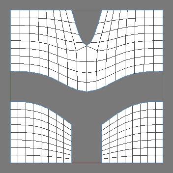

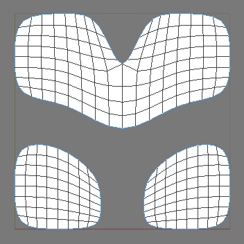

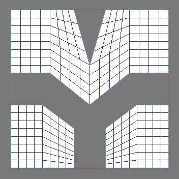

UV Smoothing
The face-varying "limit" dPdu and dPdv vectors computed during subdivision are stored and used for shading instead of computing face-constant dPdu and dPdv vectors on the fly during shading. This can be useful for anisotropic shaders but has a storage cost. Choose between linear, pin borders, pin corners, or smooth.
| linear (Pin All) | pin_borders | pin_corners | smooth (Pin None) |

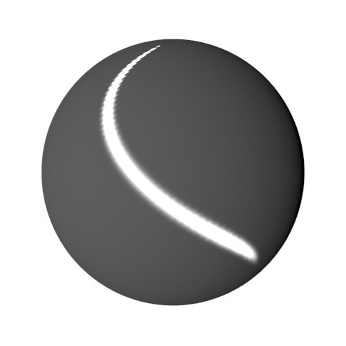

Smooth Tangents
You may notice faceting appear in specular highlights when using anisotropy. It is possible to remove the faceted appearance by enabling s mooth subdivision tangents (via Arnold subdiv_smooth_derivs parameter). Take into account this requires a subdivision iteration of at least one in the polymesh to work.
Below is an example consisting of a sphere with an anisotropic highlight. On the left image, polygon faceting is noticeable in the specular highlight. On the right image, the specular highlight is much smoother because Smooth Subdivision Tangents has been enabled for the mesh.
| smooth_tangents: off. Highlight is very 'faceted'. | subdiv_iterations: 1. Highlight is slightly improved. | subdivision_tangents: on (subdiv_iterations: 1). Highlight is much better. |
If enabled, it will compute smooth UV derivatives (dPdu and dPdv), which is the reason you need a UV map associated with the object).
When the option is disabled, these derivatives are constant per triangle, which results in a faceted appearance whenever dPdu and dPdv (like in the anisotropic computations from the Standard shader).
Enabling this option will have a memory overhead (roughly 100 extra bytes of data per vertex per keyframe).

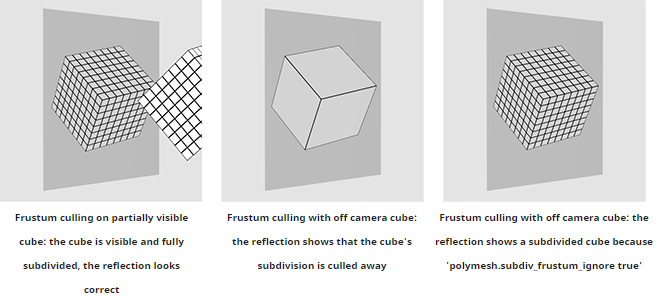

Ignore Frustum Culling
Disables Subdivision frustum culling of the mesh.
