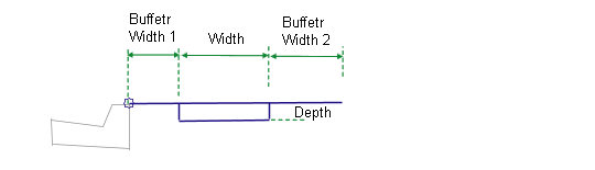

The links for the inside buffer zone, sidewalk, and outside buffer zone are inserted outward from the attachment point at a horizontal slope. The buffer zones may be omitted by setting their widths to zero.
Layout Mode Operation
In layout mode, this subassembly draws the buffer zone and sidewalk as specified by the input parameters.

Coding Diagram
