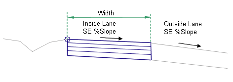

This subassembly creates a cross-sectional representation of finish grade, base layer, and subbase layer for a travel lane, applying the Inside Lane superelevation slope value for the corridor model’s baseline alignment.
It is used for the inside lanes on divided, broken-back highways. The pavement structure follows the standards described in “Pavement Structure on Paved Sections” in the Autodesk Civil 3D Help.
The attachment point is at the inside edge of lane on the finish grade surface. This component can be attached to either the left or right side.

Behavior
The Inside Lane superelevation slope is obtained from the superelevation specifications for the baseline alignment. Starting at the attachment point, a finish grade surface and parallel subgrade are inserted using the given width, depth, and the superelevation slope. Vertical links close the shape at either end of the lane.
If an offset horizontal alignment name is assigned to the Width during corridor modeling, the width of the lane will vary to match the offset of the alignment.

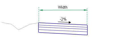

Layout Mode Operation
In layout mode, this subassembly displays the lane links using the given width and depths at a slope of -2%.
