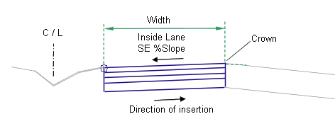

This subassembly creates a cross-sectional representation of a travel lane that is being inserted from the inside edge of pavement towards the crown point.
It uses the Outside Lane superelevation slope value for the corridor model’s baseline alignment. The pavement structure follows the standards described in “Pavement Structure on Paved Sections” in the Autodesk Civil 3D Help.

Crown Point on Inside |
Specifies that the inside edge of travelway be coded as Crown |
Yes / No |
Yes |

Behavior
The Inside Lane superelevation slope is obtained from the superelevation specifications for the baseline alignment, and the algebraic sign of this value is reversed. If inserting to the left, the Right Outside Lane Slope is obtained and reversed; if inserting to the right, the Left Outside Lane Slope is obtained and reversed. Starting at the attachment point, a finish grade surface and parallel subgrade are inserted using the given width, depth, and the reverse superelevation slope. Vertical links close the shape at either end of the lane.

In layout mode, this subassembly displays the finish, base, and subbase links for the given width and depths at a -2% slope.

Coding Diagram
will be displayed in layout. For more information, see
