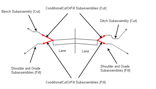

The following illustration shows a corridor assembly section comprised of:
- a left and a right side lane
- four ConditionalCutOrFill subassemblies (two on the left side and two on the righ side)
- The top left side ConditionalCutOrFill subassembly is configured to automatically add a Bench subassembly when Autodesk Civil 3D detects that the assembly is in a cut condition.
- The bottom left side ConditionalCutOrFill subassembly is configured to automatically add Shoulder and Grade subassemblies on the left side when it detects that the subassembly is in a fill condition.
- Similarly, the top right side ConditionalCutOrFill subassembly is configured to add a Ditch subassembly when it detects a cut condition, while the bottom right side ConditionalCutOrFill subassembly adds Shoulder and Grade subassemblies when it detects a fill condition.
You can add one or multiple ConditionalCutOrFill subassemblies to an assembly, thereby creating simple or complex conditional behaviors in assemblies. For example, in the previous example, you can also add a ConditionalCutOrFill subassembly that automatically daylights at a given slope when it detects that it is in fill condition greater than 3 meters, or some other specified value. Similarly, you can add a ConditionalCutOrFill subassembly that automatically applies widening when it detects a fill condition of greater than a specified value.
