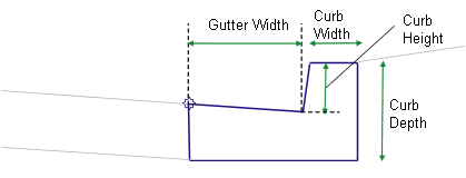

This subassembly creates a a simple curb and gutter structure at the inside or outside edges of roadway.
The attachment point is at the flange point of the gutter or back of the curb.

The subassembly builds the shape for a simple curb and gutter with the attachment point either at (a) the inside edge of the gutter (or lip), or (b) the back of the curb. The face of the curb is given a small, constant width to make it non-vertical.
