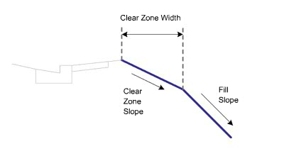

The berm is optional in fill conditions. If no berm is included, a clear zone slope is added, and then a daylight fill slope is added.

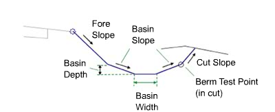

This subassembly builds the links for the basin foreslope and the basin out to the basin test point. If a profile is given, the width of the foreslope varies to hold to the basin profile. If the basin test point is in cut, the daylight intercept is calculated on the target surface at the given cut slope.

If it is in fill, and Berm is set to Omit, a link is added from the attachment point at the Clear Zone Slope until the Clear Zone Width is met. Then a daylight link is added to the target surface at the fill slope specified. If the clear zone link intersects existing ground, it will stop at this intersection point.

Layout Mode Operation
In layout mode, this subassembly draws the foreslope, basin side slopes, and basin bottom with the given input parameter values. Both the cut and fill condition links are shown in dashed lines, with the daylight links extended outward, for a width of 3 meters (or 10 feet) at the given slopes. The daylight links terminate in arrowheads pointing outwards.
