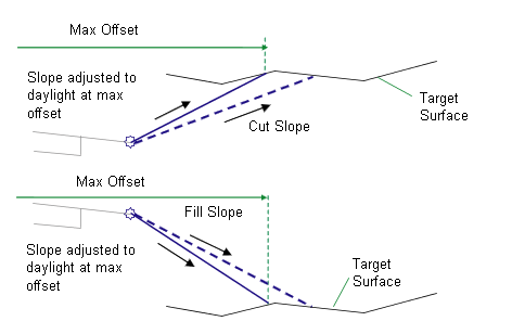

This subassembly inserts a link that extends to a target surface at a user-defined cut or fill slope.
If necessary, the slope is adjusted to keep the daylight point within a maximum +/- offset from the baseline.
You can also specify optional lined materials for daylight and other links (All Links, Daylight Links, Fill Links Only, and None).

Behavior
This subassembly attempts to calculate a daylight point for the cut condition. If a daylight point is found, its offset is compared to the Max Offset value. If the Max Offset value is exceeded, the daylight point is moved to the maximum offset point on the target surface. If no cut daylight point is found, the process is repeated for the fill condition.
If an offset horizontal alignment name is assigned to the Max Offset during corridor modeling, the value of the Max Offset will vary to match the offset of the alignment.

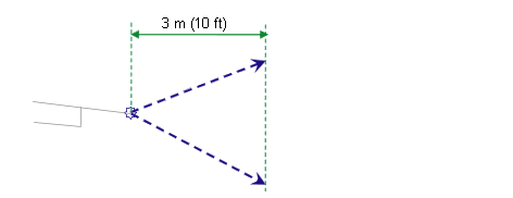

Layout Mode Operation
In layout mode, this subassembly displays both the cut and fill slopes in dashed lines extended outward for a distance of 3 meters or 10 feet. The daylight links are terminated with arrowheads pointing outwards.
