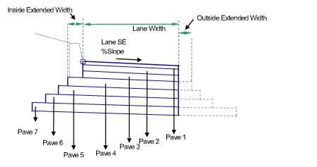

This subassembly creates a cross-sectional representation of a lane comprised of multiple layers. The layers can be of varying widths. It also applies the Outside Lane superelevation slope value for the corridor model's baseline alignment.
The attachment point is at the inside edge of lane on the finish grade surface. This component can be attached to either the left or right side.

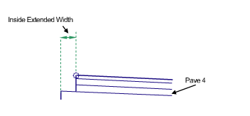

Each layer has its own separate extension options both on the inside and outside. The inside and outside extensions specify the additional width on the inside or outside relative to the pavement layer immediately above.
Example 1:
Pave4 Inside Extended Width = 0.5m
Pave4 Outside Extended Width = 0m
If inserted on the right side,

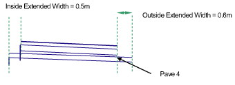

Example 2:
Pave4 Outside Extended Width = 0.6m

The pavements layer widths may be specified using the following methods:
- By specifying that the pavement width will be the same as the pavement immediately above.
- By specifying a pavement width.
By specifying an inside and outside pavement layer extended width so that pavement layer width will be the distance between the inside and outside offsets.
By specifying an inside pavement layer extended width and pavement width so that the outside pavement layer is automatically calculated.

Coding Diagram
