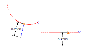

Select the location of the perpendicular point and then specify a distance by picking two points or entering a value.
  1. Click Home tabDraw panelLine drop-downCreate Line Perpendicular From Point Find.
  2. Select the arc or line object to extend the line from.
  3. Specify the point on the object where the line will extend from.
  4. Specify a distance by either clicking in the drawing or entering a distance.
