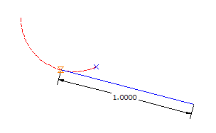

Select the location of the tangent point and then specify a distance by picking two points or entering a value.
Click
Find.
- Select the arc or line object to extend the line from.
- Specify the point of tangency on the object.
- Specify a distance by either clicking in the drawing or entering a distance.
