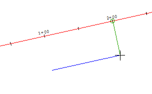

An alignment must exist in the drawing to use this command.
  1. Click Home tabDraw panelLine drop-downCreate Line Station/Offset Find.
  2. Select the alignment.
  3. Specify a station by either entering a station value or clicking in the drawing.
  4. Specify a distance by either entering an offset or clicking in the drawing.
  5. Specify a station and offset for the next point in the line. Or press Enter to return to the Line command prompt where you can use additional options to define the line.
