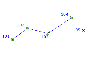

To Create Lines Through Specified Point Objects
To select the points, you can select any part of the point objects, such as the marker or the label.
  1. Click Home tabDraw panelLine drop-downCreate Line By Point Object Find.
  2. Select the start point in the drawing.
  3. Select the next point in the drawing.
  4. Continue to select points to define additional line segments. Or press Enter to return to the Line command prompt where you can use additional options to define the line.
