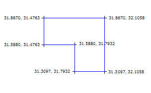

To Create Lines by Specifying Northing/Easting Coordinates
The order of the prompts is controlled by the Transparent Command Ambient drawing settings.
  1. Click Home tabDraw panelLine drop-downCreate Line By Northing/Easting Find.
  2. Enter a northing value.
  3. Enter an easting value.
    Note: The order in which you are prompted for northing and easting is controlled by the Transparent Command setting Prompt For Easting Then Northing, located on the Ambient Settings tab of the Drawing Settings dialog box.
  4. Continue to enter northing and easting values to define the line segments. Or press ESC to return to the Line command prompt where you can use additional options to define the line.
