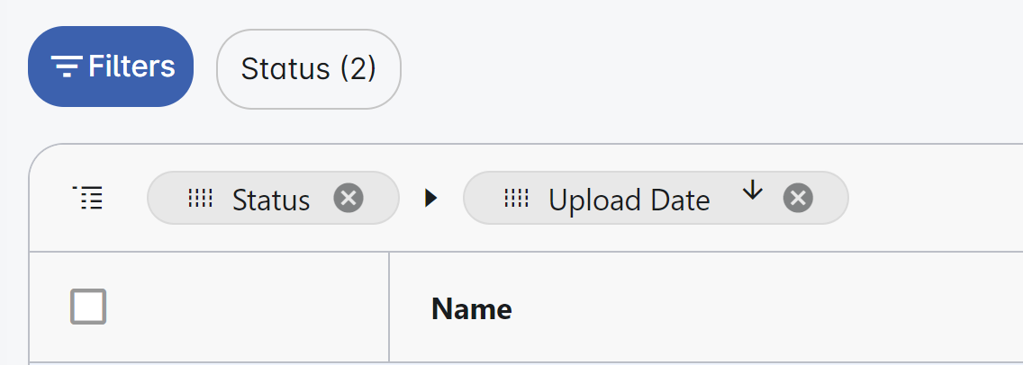

When viewing Upload Requests be sure to adjust the filters and grouping at the top to ensure you can see what's pertinent to your task.

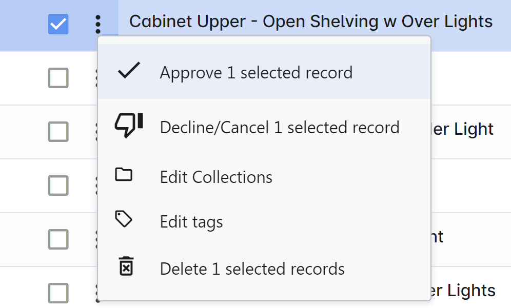

  1. Select one or multiple items check box
  2. Select the 3 vertical dots next to the selection to approve, decline, edit collections, edit tags, or delete.

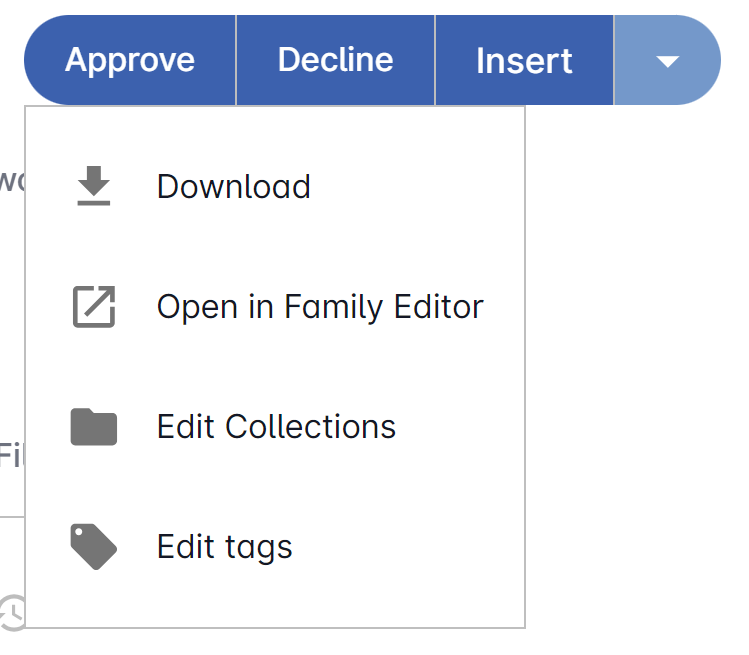

How to approve and decline content uploaded
Once you have reviewed the content you can approve or decline the content.
  • Approve will change the status to approved and make the content available to the collections that are chosen for it
  • Decline will set the status to decline and allow the content to exist but only be visible by admin
Note: If you wish to remove content from content catalog you must use the Delete option.
