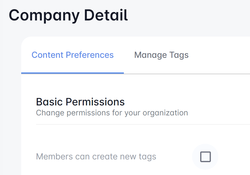

Note: A company can choose to allow or prevent users from creating new tags from the Company Detail basic Permissions settings as seen below.

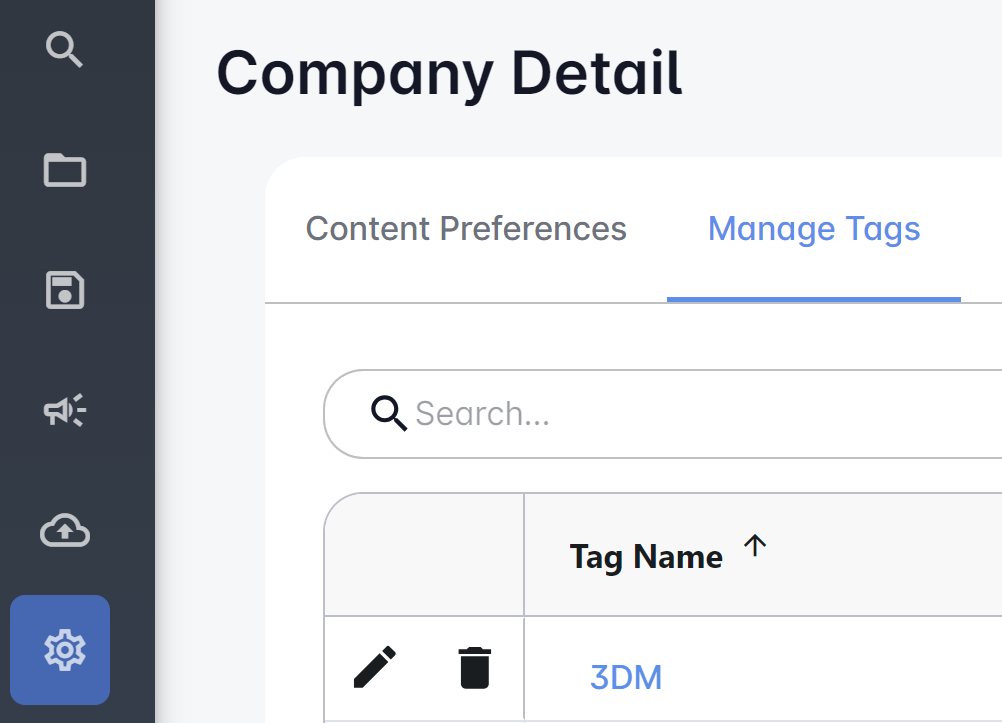

How to access Manage Tags
Manage Tags
To access Manage Tags, select the Company Details icon on the left navigation (Gear Icon) and choose the tab Manage Tags.

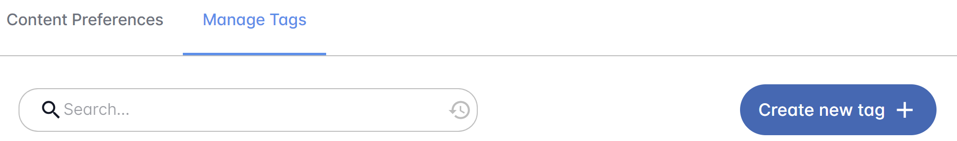

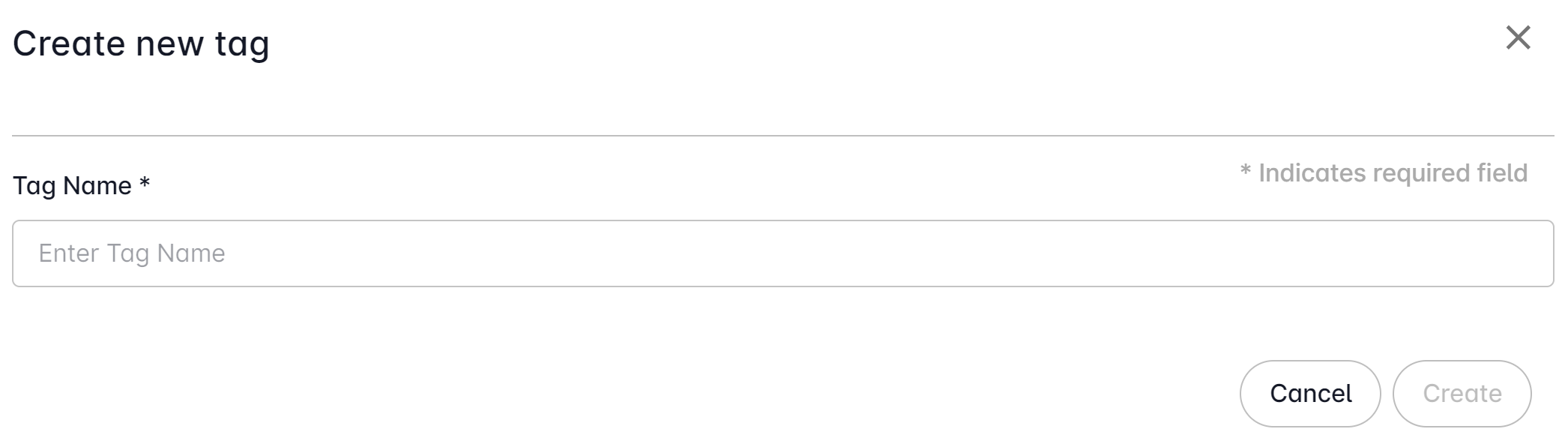

How to create new Tags
  1. Select the Create new tag + button on the right. This will allow you to create new tags that haven't been used on any of your content before. This is a great place to make tags that you would like others to use when adding tags to content.
Manage Tags
  1. Add the tag in the field provided and select Create.
Manage Tags

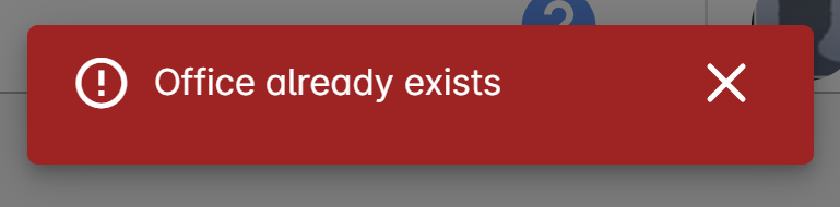

Note: If you try to create a tag that exists already you will get a popup in the upper right hand corner like below.
Manage Tags

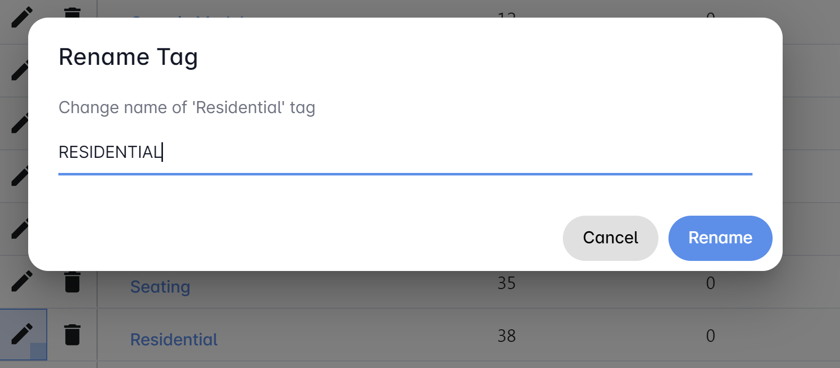

How to edit or rename existing Tags
When browsing the list of tags select Edit (pencil button) to the left of the Tag Name, then enter the new tag name you wish to replace it with and select Rename.
Manage Tags

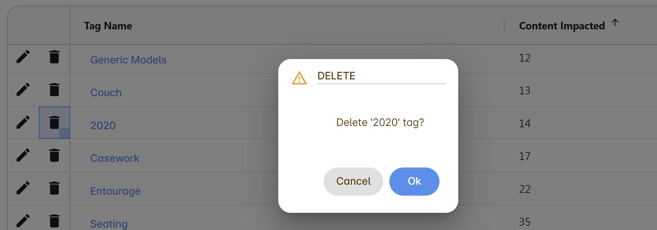

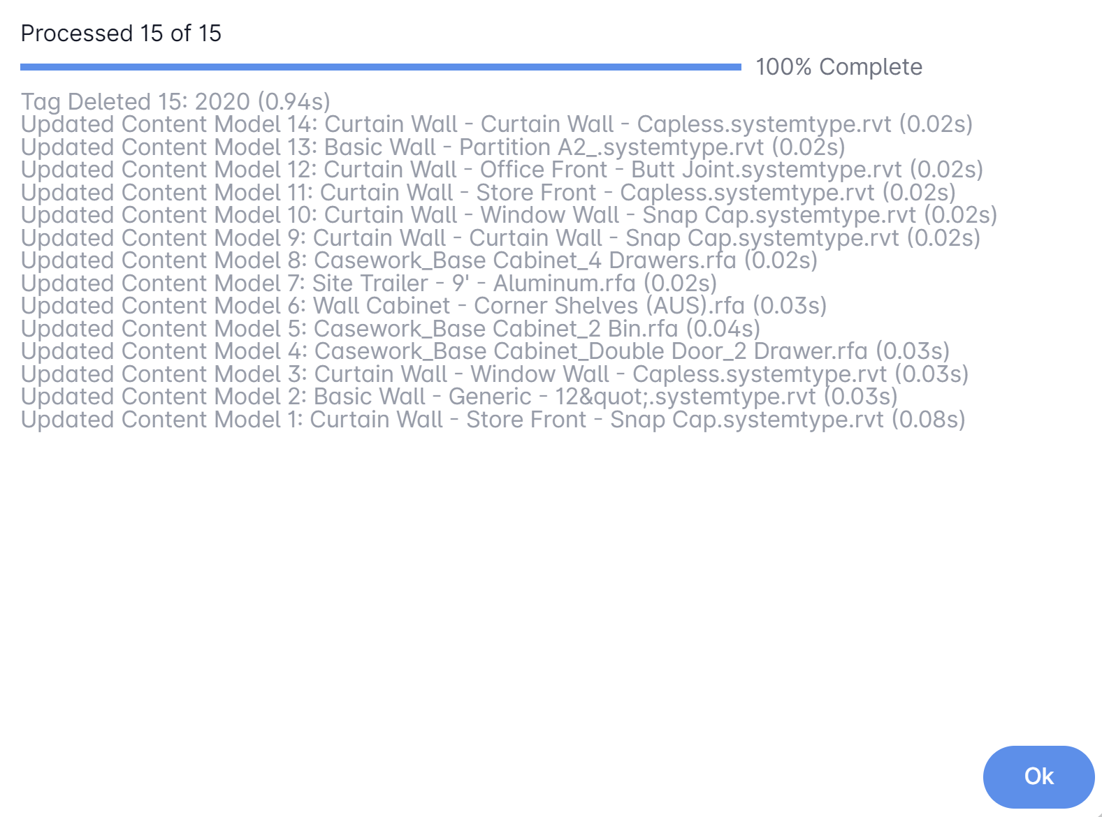

How to delete existing Tags
When browsing the list of tags, select delete (Trashcan button) to the left of the Tag Name. Take note of the number of Impacted Content and Saved Searches. This means this tag is used on the items impacted.
Manage Tags
When you are sure you want to delete the tag select Ok. All tag deletions will process and show you the record of deletions.
Manage Tags

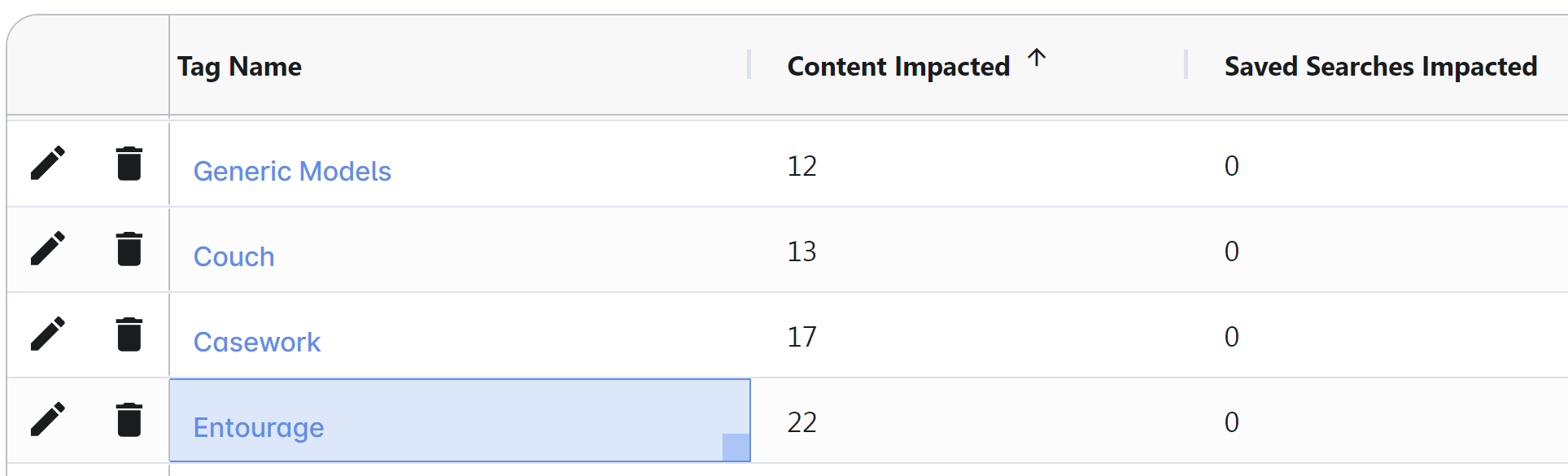

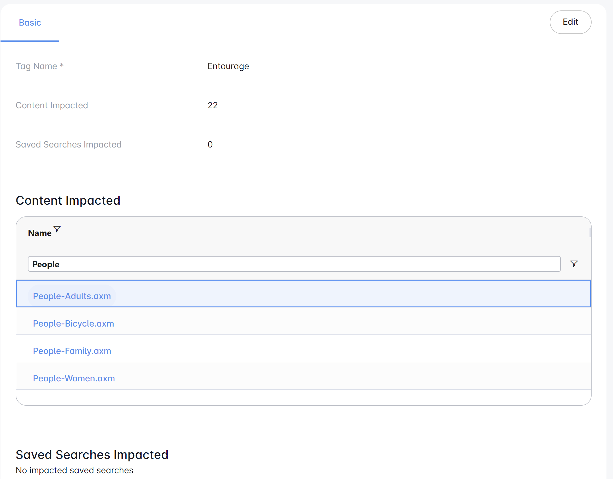

Review use of a Tag on content
Tags may be used on content inappropriately. To review what content has a given tag and what Saved Searches use that tag, select the Tag Name to see more detail.
Manage Tags
Next you will see further detail including search options for impacted content to review in further detail. simply select the name of the content to see that contents detail.
Manage Tags
