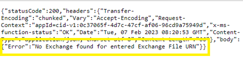

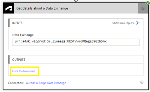

Can I get more information for a flow that has failed?
You can get details about why the Data Exchange flow failed by providing the Data Exchange URN and selecting the OUTPUT option. The details of the flow along with the common error messages are displayed in a browser.
Specify the Data Exchange URN.
Click Click to download.

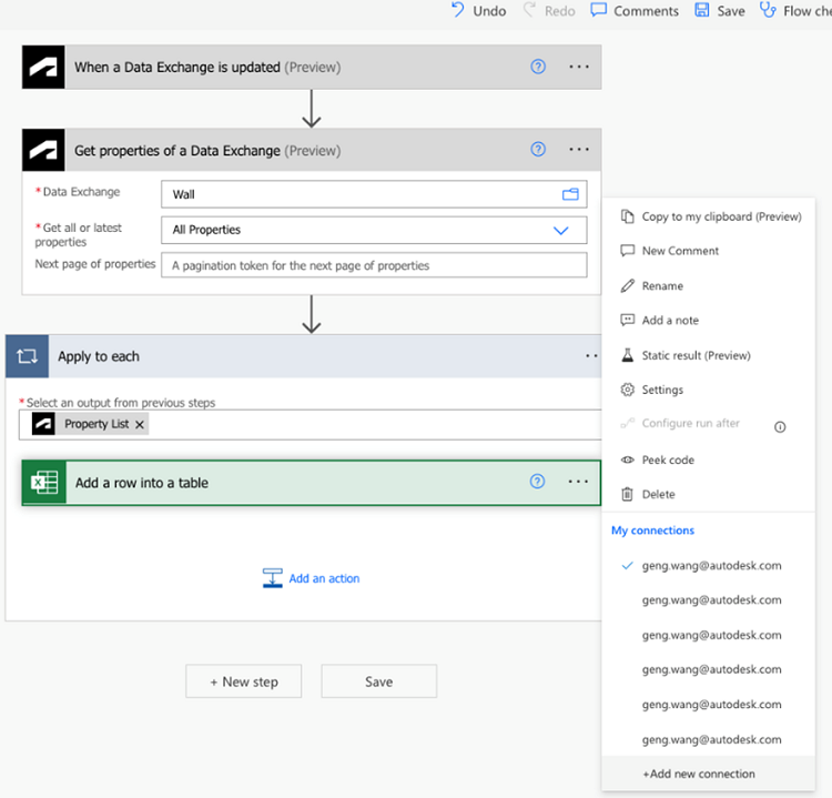

Why am I having problems accessing Excel or Autodesk Docs?
Sometimes there are problems accessing either Excel online or Autodesk Docs. Adding a new connection to the step often resolves the issue.
