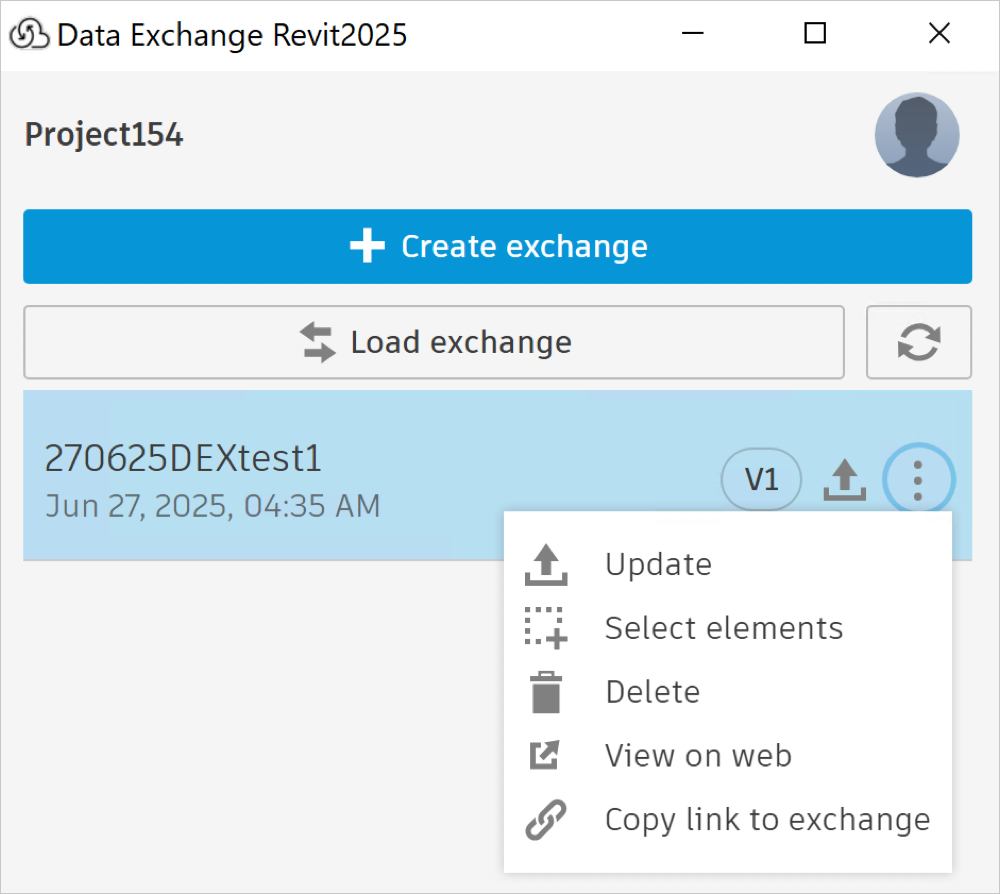

Delete an Exchange
You can delete the exchange that you created from your connector interface.
Click Data Exchange command.
Select the relevant exchange in the connector interface.
Click More menu and click Delete from the drop-down list.
Click Yes.

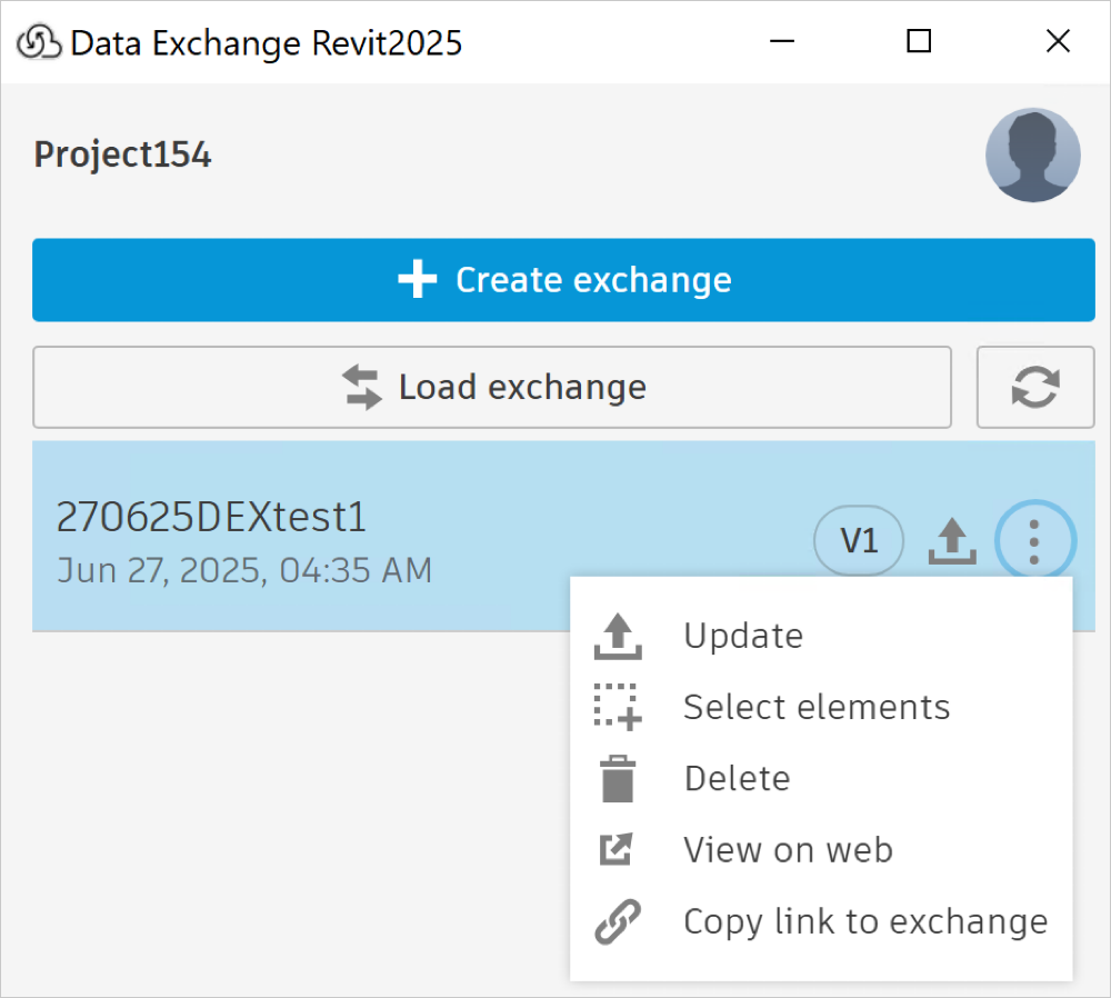

View Exchange on Web
This section explains how to view a selected exchange from the loaded exchanges list on Autodesk Docs. When you select an exchange for viewing, you will be redirected to Autodesk Docs and the exchange will be displayed on a new web browser window.
Click More menu and click View on Web from the drop-down list.
A new browser window will open where you can view the exchange in Autodesk Docs.

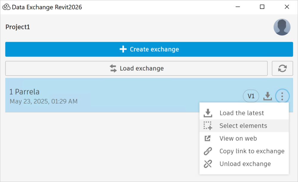

Select Elements of an Exchange
You can select the components from your Data Exchange using this feature. It helps you to identify the elements from a specific exchange in your Revit file.
Click More menu and click Select elements from the drop-down list. It highlights the selected Data Exchange elements in Revit.

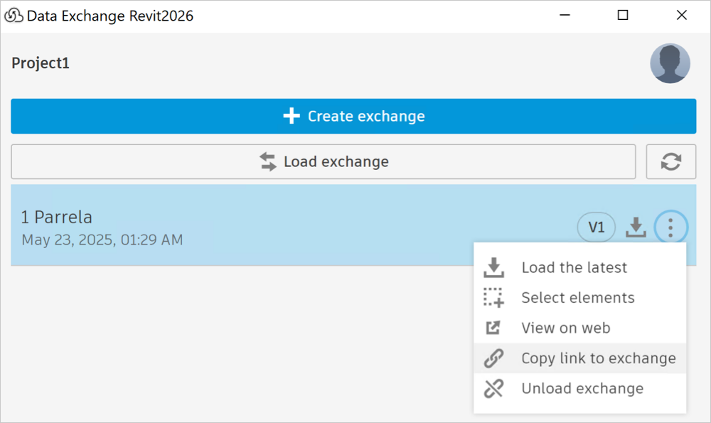

Copy Link to Exchange
You can use this feature to share or collaborate on specific elements.
After selecting the elements, click the More menu again and select Copy link to exchange. A unique link will be generated for the selected elements. This link is copied to your clipboard.
Paste and share the link via email, chat, or issue tracking tools. The recipient can use the link to view or access the same elements in their environment.
