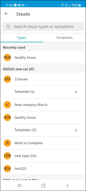

  5. Select from the Types or Templates.
    • Issues must have a type and types are preconfigured or created in the Types settings on web
    • Templates have an associated type and can contain prepopulated information to make creating issues faster. Templates are created in the Templates settings on web

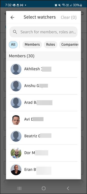

    • Watchers: Tap Members, Roles, or Companies.
      Tip: Use the search box to find members, roles, or companies by name.

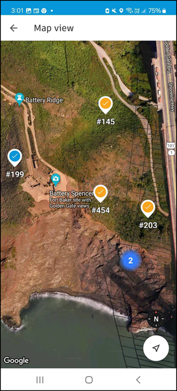

    • GPS locations: Tap the Map icon at the top of the Issues list to view the location of project issues on the map. Tap the issue pin or your choice to view and edit details of this issue. See GPS Locations on Issues on Android for more information.

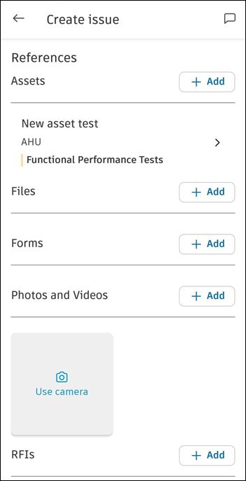

    • Attachments: Take a photo with your camera or attach a file from your device.
    • References: Navigate to the References section, tap Add next to the tool of your choice, and then select the file for which you want to create a reference. References are links to files that exist in other ACC tools like Assets, Forms, Files, Photos, Sheets, or RFIs. See Issue References and Attachments for details.

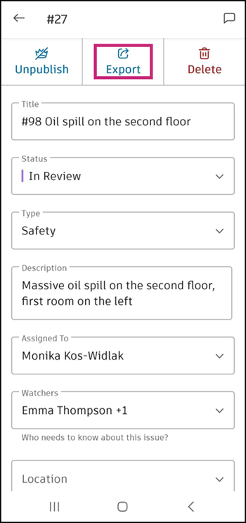

  1. In the Issues tool in the Autodesk Construction Cloud mobile app, tap an issue you want to edit.
  2. To publish or unpublish, tap the Publish or Unpublish icon accordingly.
  3. Tap Export to create and send a detailed summary report of this issue to your email.
  4. To delete, tap the Delete icon.

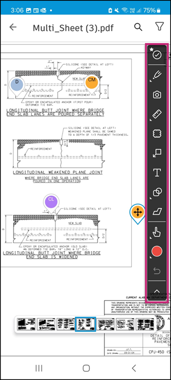

Work with Issues Placed on 2D Files in the Viewer on Android
You can place your issue on a 2D file/sheet when creating issues in web.
  1. Follow steps 1-6 given above to open your issue in the viewer.
    Issue pins indicate places where issues have been placed on a sheet or file.
  2. Tap the desired issue pin to edit issue details on your issue.
  3. Tap to apply search terms.
  4. Tap (available on issues placed on sheets) to compare sheets
  5. Tap to filter the issues by any of the following:
    • Visibility: Hide everything, Hide refence badges, Hide autohyperlinks
    • Share status: Published markups, Unpublished markups
    • Issues: You can toggle on the Only show Issue pins option
    • Markup references: Sheets, Files, RFIs, Forms, Submittals, Assets
    • Markup types: Drawing, Pen, Highlighter, Text, Cloud, Callout, Shapes, Arrow, Line, Rectangle, Ellipse, Cross, Polygon, Polyline, Photo, Measurements, Ruler, Freeform ruler, Area rectangle
    • Markup colors: Choose from a variety of colors
  6. Tap (available on issues placed on sheets) to view the sheet's revision history and asset markups
  7. Tap the More menu to view recently viewed sheets, export sheets, add them to favorites, and view sheet details.
  8. Use the tools in the toolbar to create markups. See Markups Toolbar for more information.

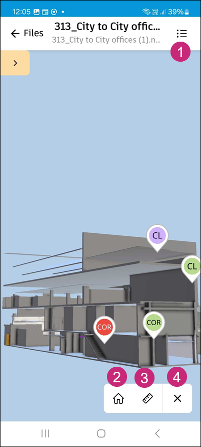

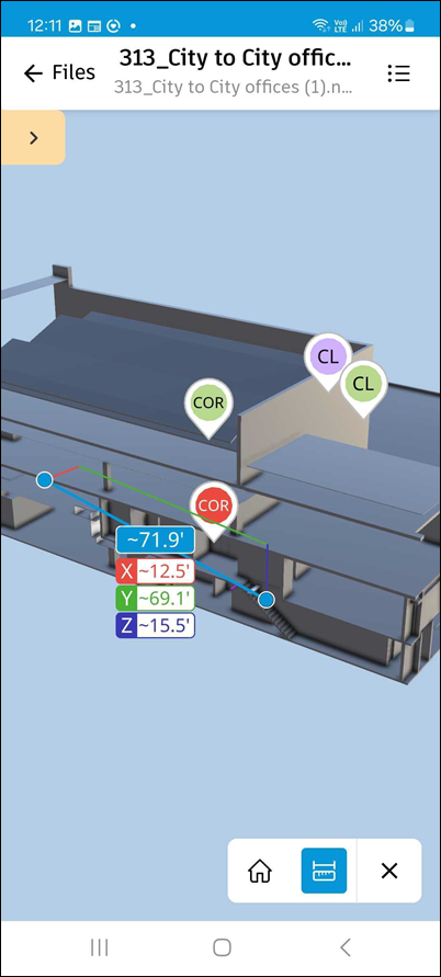

Work with Issues Placed on 3D Models in the Viewer on Android BETA
Note: This feature is now available in public beta. The functionalities described are what is available during this phase. See BETA Viewer on Mobile for more information.
You can place your issue on a 3D model when creating issues in web.

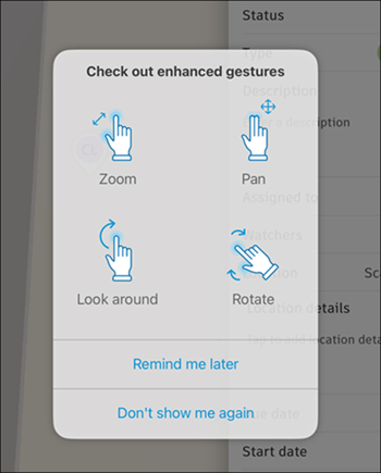

  2. The following gestures are available: Zoom, Pan, Look around, and Rotate.
  3. Tap Turn on BETA viewer! at the top of the screen to access the new functionality and view issues placed on a 3D model.

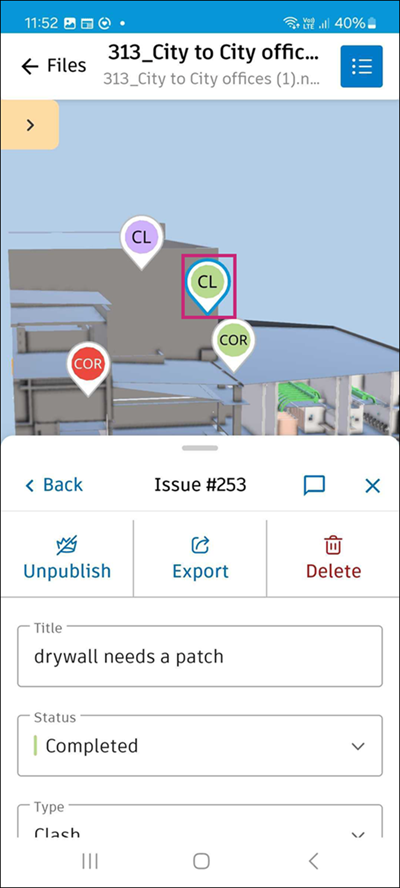

    Issue pins indicate places where issues have been placed on a model.
  4. Tap the desired issue pin to view and edit details of this issue, export, delete, publish, or unpublish the issue.

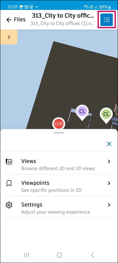

  • Tools: The following numbers correspond to the numbers in this screenshot.
    1. Menu: Tap the menu to access the following:
      • Views: View any 2D or 3D views associated with your model
      • Viewpoints: View any existing viewpoints in your model
      • Settings:
        • Review the hand gestures
        • Hide the BETA viewer banner
        • Send BETA feedback
    2. Home view: Tap to return to the default view.
    3. Measurement: Tap to open menu and perform the following actions:
      • Measurement: Tap to measure the distance between two points.
      • Laser measurement: Tap to obtain dimensions and shortest distance to the nearest object.
    4. Close: Tap to collapse the toolbar.

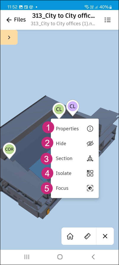

  • Viewing options: Tap on any object in the model to receive further viewing options. The following numbers correspond to the numbers in this screenshot.
    1. Properties: View the selected object's properties.
    2. Hide: This will hide the selected object. Tap to show.
    3. Isolate: View only the selected item.
    4. Section: Provides a single face to cut the model along X, Y, or Z planes.
    5. Focus: Tap to bring the selected object into the center of your view.
Other considerations:
  • Changing issue status is reflected in the change of color of the issue pin
  • Changing issue type is reflected in the change of text displayed in the issue pin
  • Deleting an issue removes a pin associated with this issue from the viewer

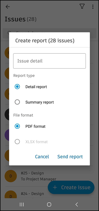

Export Issues on Android
In the Issues tool in the Autodesk Construction Cloud mobile app, you can generate an Issues report and email it to yourself.
  1. To export an individual issue, tap on the issue and tap Export.
  2. To export multiple issues or all the issues in your project, tap on the more icon at the top-right corner.
    • For all issues, tap Create Report.
    • For multiple issues, tap Select Issues.
      • Select issues from the log.
      • Tap Create issue report at the bottom of the log.
  3. Edit the title of the report.
  4. Select a report type: Detail report or Summary report.
  5. Select a file format if applicable.
  6. Tap Send report.
See Issue Reports for more information about reports generated in the Issues tool.
