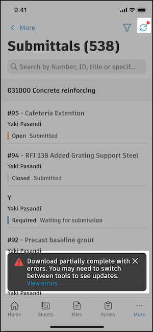

After the partial and full download, you may be notified that the download was complete with errors. The sync icon will have a red dot on it.
To troubleshoot in-project sync errors:
  • In the banner, click View errors.
  • If you miss the banner, click the sync icon with the red dot on it and in the drawer that appears, you can:

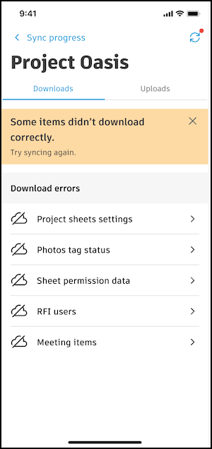

    • Try again
    • View errors
    • Cancel sync (only available after the partial download is complete)
Clicking View errors will take you to the Downloads tab in the Sync Status tool. Review the errors to resolve as needed.
