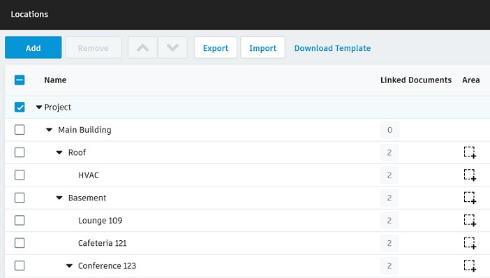

  5. Create your project's location hierarchy.
Build the hierarchy using the following methods:
  • You can select a location in the hierarchy and click Add to create a sublocation.
  • You can use the arrows to move items up and down in the hierarchy.
  • You can import the entire hierarchy from an Excel spreadsheet.
Note: Linked Documents shows how many documents have been linked to each location. The icon in Area shows that the area has been defined.

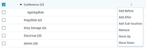

Other Location Menu Options
Click the more menu for further options.
  • Add Before: Adds a location before the selected location at the same level.
  • Add After: Adds a location after the selected location at the same level.
  • Add Sub-location: Add a location below the selected location.
  • Remove: Removes the selected location.
  • Move up: Moves the selected location up.
  • Move down: Moves the selected location down.
